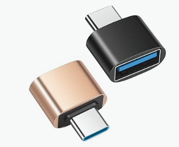

Edit: Problem solved! After added un adapter (usb c to usb a) on the thunderbolt 3 port, then connect iPad Pro with a usb a to usb c cable. Really ridiculous!
