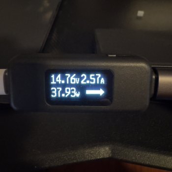

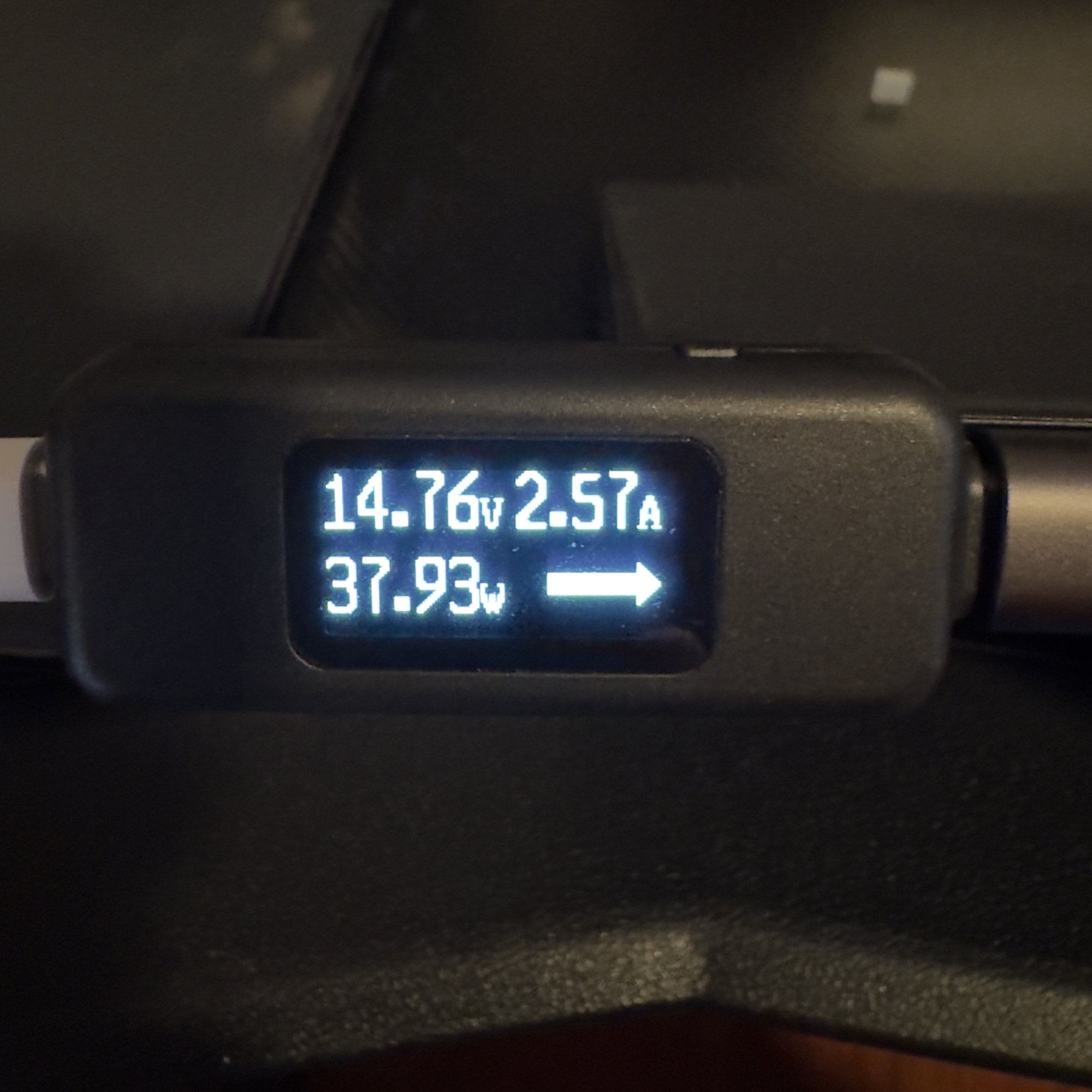

I have used a 140w Apple power brick and the 240w USB-C Apple Cable. This is the best I can get using the pass through charging port in the Magic Keyboard case and the same speed connected directly into the M4 iPad Pro.
As I don’t have in the moment a M4 handy, I measured quickly with the 12.9“ M1.
The output from the TB port to an other device is only 7.5 W (5 V by 1.5 A). That is in the spec from USB-C so defined as minimum.
And it doesn’t matter if the iPad Pro is also charged via Magic Keyboard or not. I assume this is the same with the M4. You may test this as well.
