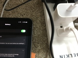

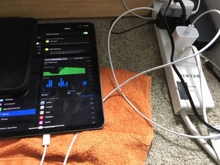

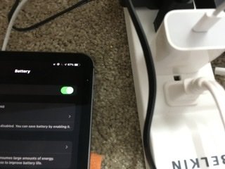

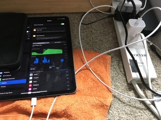

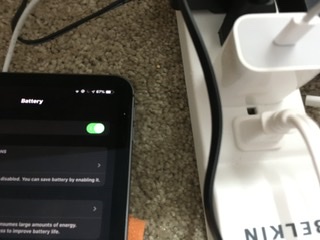

me too, ipad 2020 11" cellular
cant take to genius bar
this is disheartening considering 1200$
found it when trying to use a hub and noticed my wired headphones didnt work with oem apple adapter
