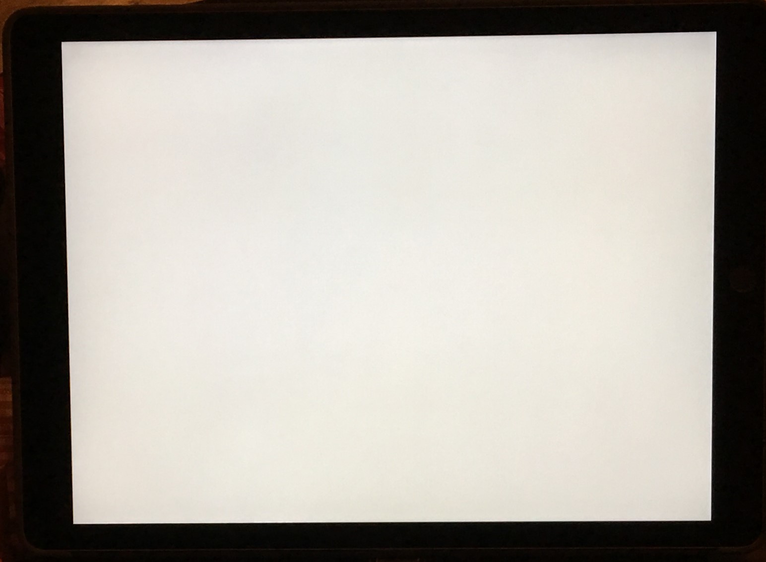

Well that is certainly better although it still looks a bit brighter in the middle, although nowhere near as much. So perhaps your iPad is a bit darker towards the edges? What do you see in reality here? In terms of colour uniformity it is towards the warmer side but I don't see any variations that scare me. Yes it is not perfect, but it is what I would call within tolerance. Is it bothering you?
By the way, I posted a screenshot of mine in the "Yellow" thread. Did you see it? It isn't perfect either.
Keep in mind when you take/look at photos that IPS has some angle effects that produce that vignette effect (brighter in center). Move the camera around and you'll see that the bright spot follows the center of the frame and not the center of the display. The angle can change this effect too. It's less visible to the human eye vs. cameras.

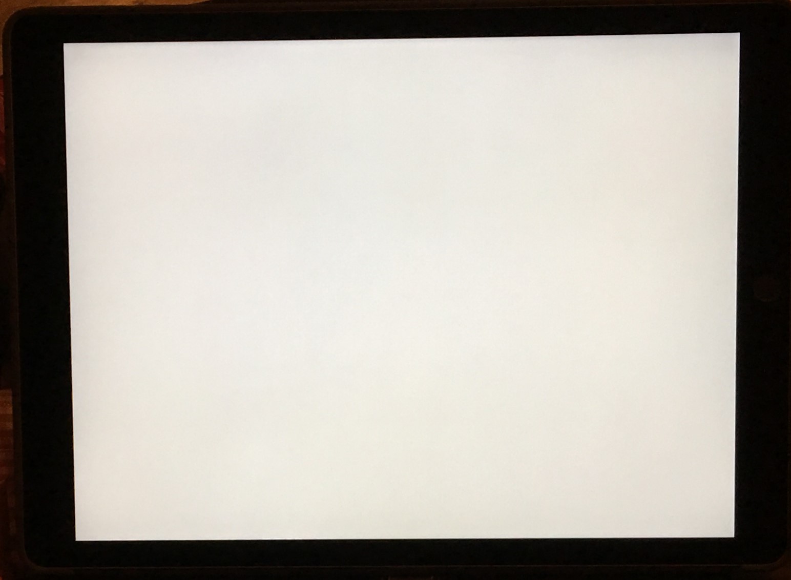

True indeed, but that's why I told JPizzle to take the screen with the camera further away and then crop it. This is what I did with mine, picture repeated below, and as I mentioned in another thread, I know full well its not perfect (more yellow towards the bottom). The reality is that it is less yellow overall than the picture below implies (as the camera itself introduced a slight deviation due to its own white balance). But I have seen far worse so I am not swapping it out. Overall it is warmer than the iPhone 6S Plus that I have.

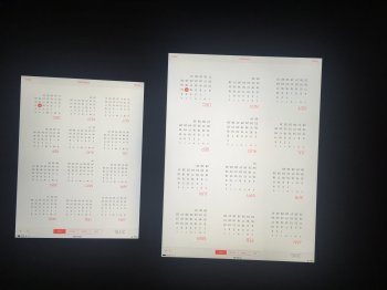

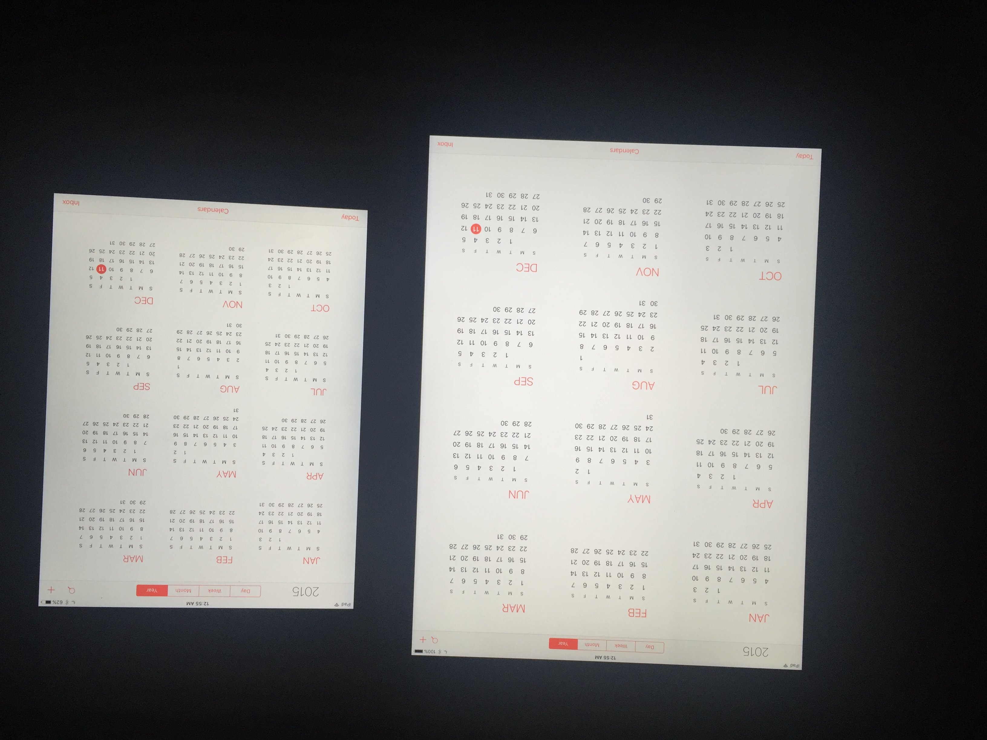

Here's a more off center pic comparing it to my iPad Air. It looks like the bright spot shifted to the left to where the camera is centered, which would support walrus' explanation. Also it appears the color is uniform although not as cool blue as my iPhone.
