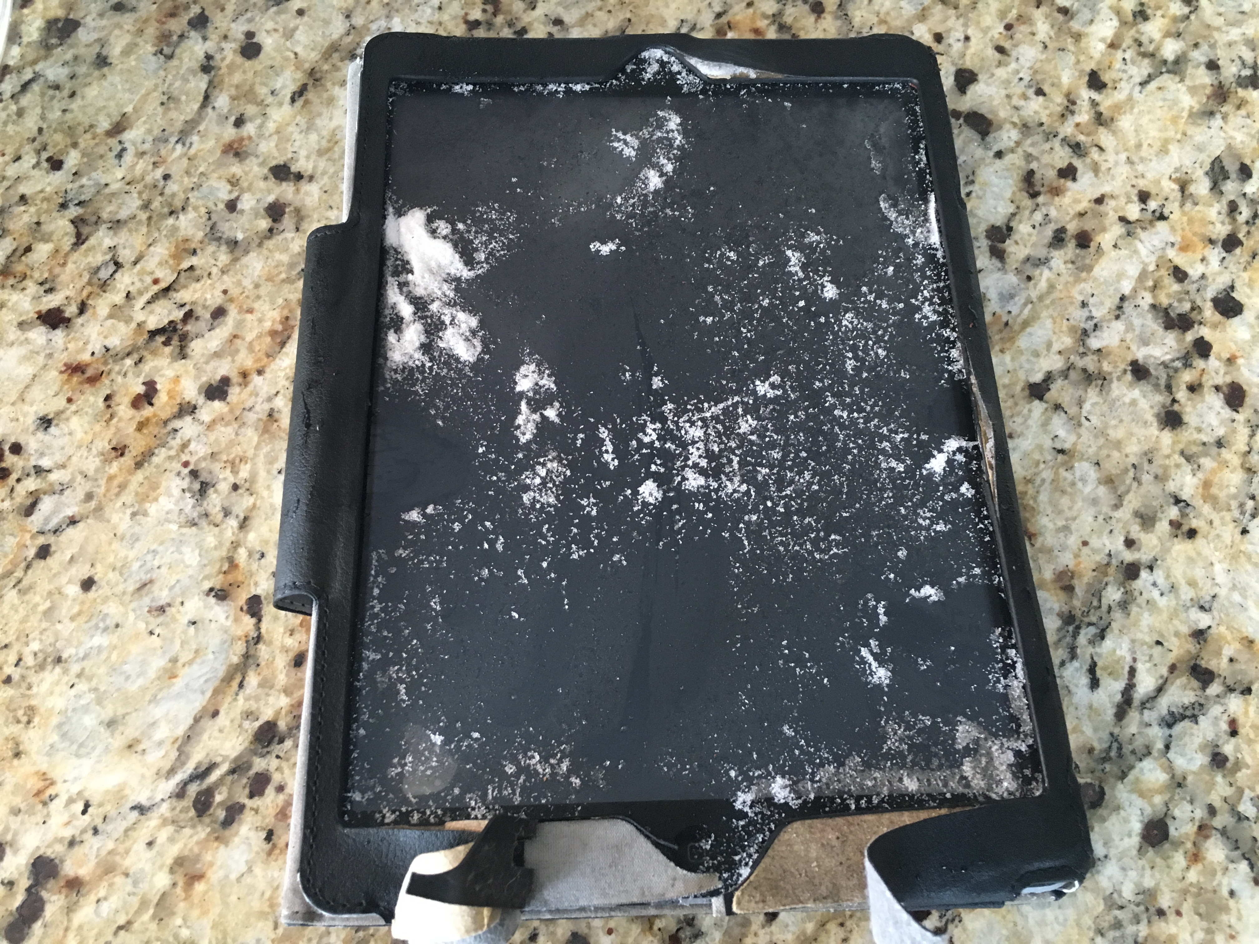

My kids lost my iPad last December. By the time I realized it was missing the battery had died and find my iPad didn't report its location because it's been over 24 hours (a limitation I think Apple should remove).
This morning my youngest son wanted to play outside in the snow and this is what we happened upon inside the kids' playhouse, the case literally frozen to the ground that I had to cut off the flap:
After thawing out:
There's some minor condensation under the digitizer on the right side, but otherwise fully functional. Wondering if I should bother removing the digitizer to get that cleared up. Kinda counting my blessings and don't want to make it worse.

How long did you let it thaw for? If there is still moisture inside, there is still the potential for damage or for it to quit. I'd probably leave it powered off for another week until that condensation is gone.
I left it inside my house for about an hour and then used a hair dryer to get most of the condensation out. At this point I restored the device completely and have it syncing my entire photo library over. I'll probably power it off and place it somewhere safe for a week (per your suggestion).
I'll cross my fingers for you that nothing gets shorted out during your sync. I know the phones are pretty tight for space inside so water can get trapped behind components where it's not easy to dry out. Hopefully the iPad has a bit more space wiggle room.

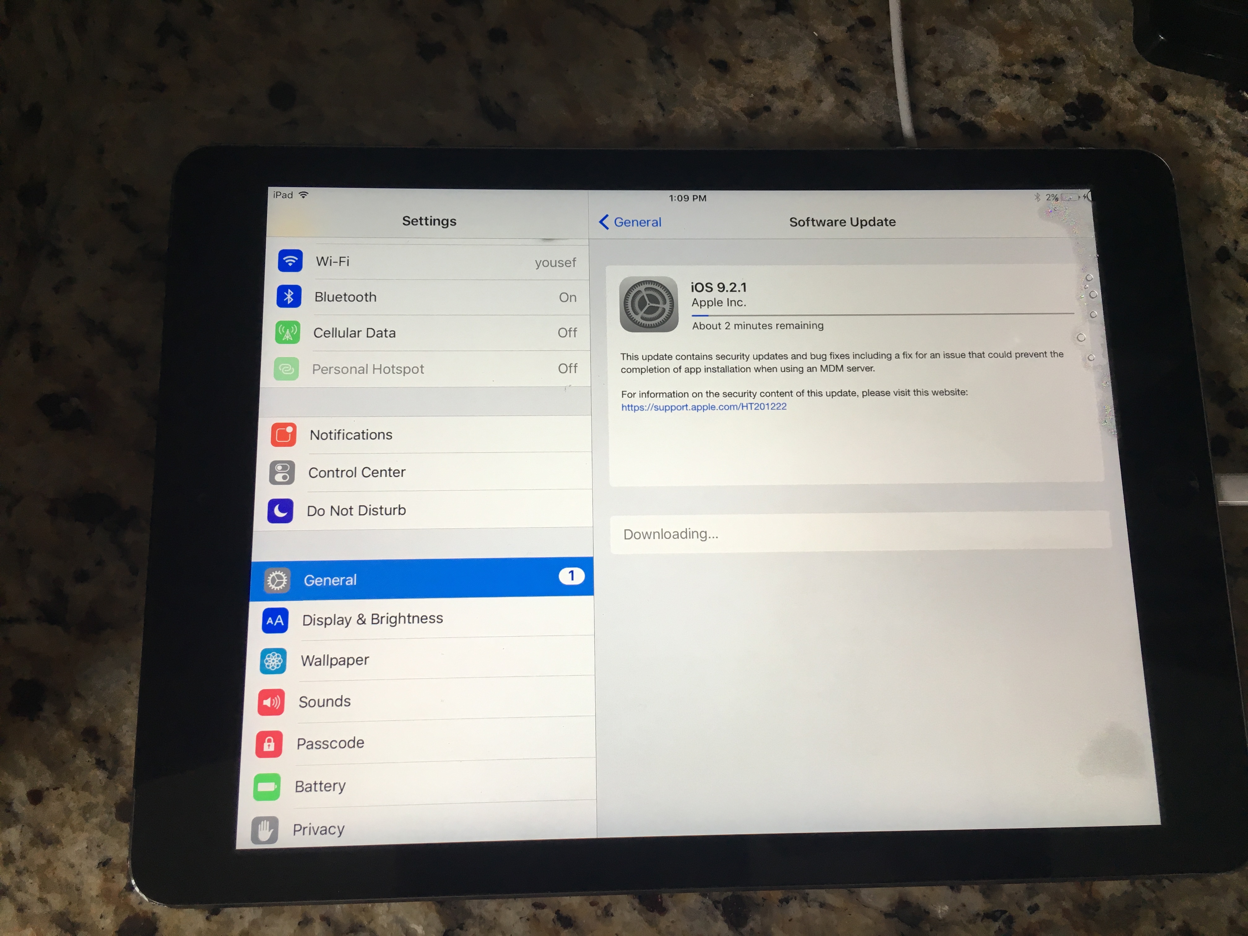

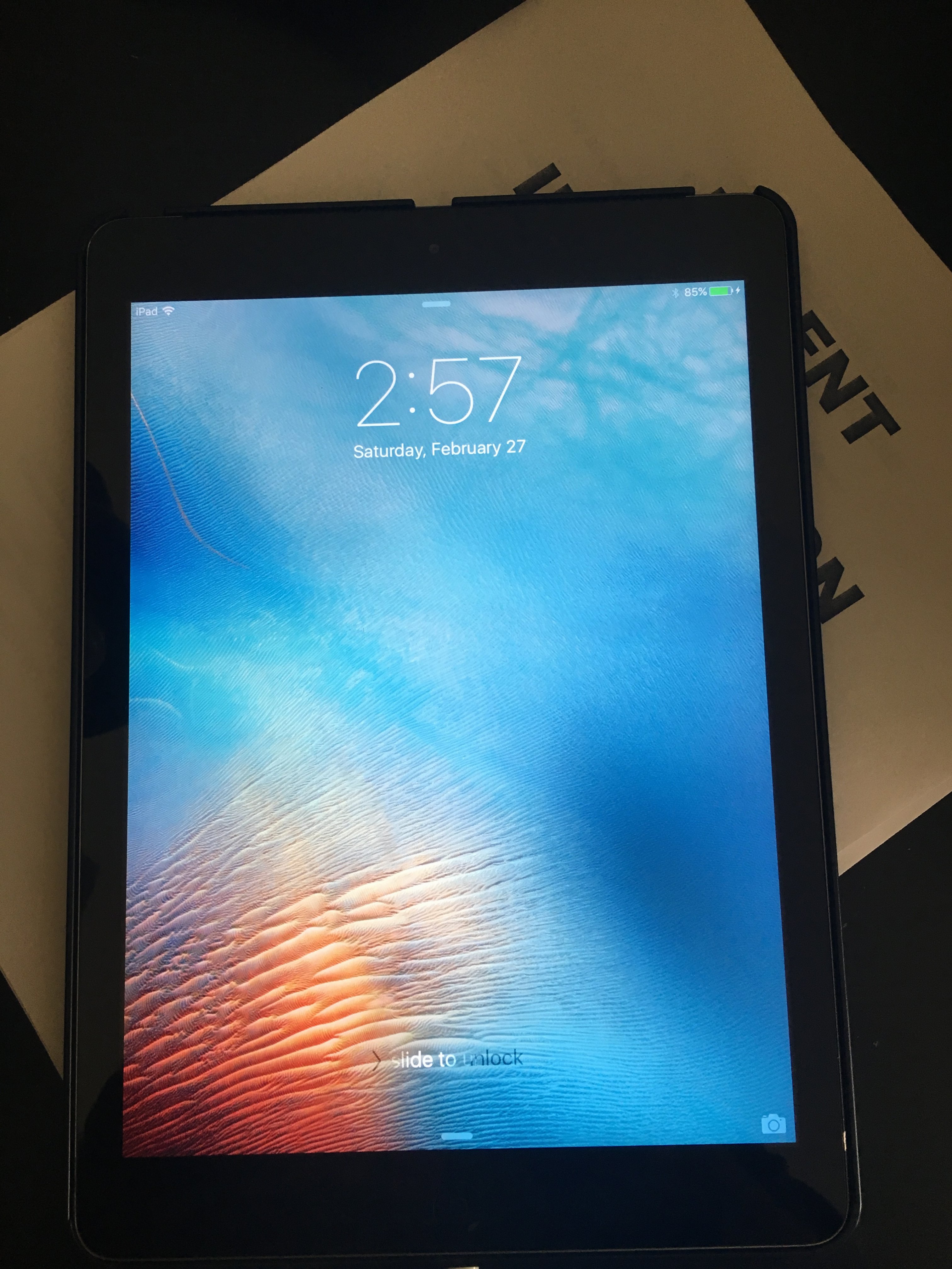

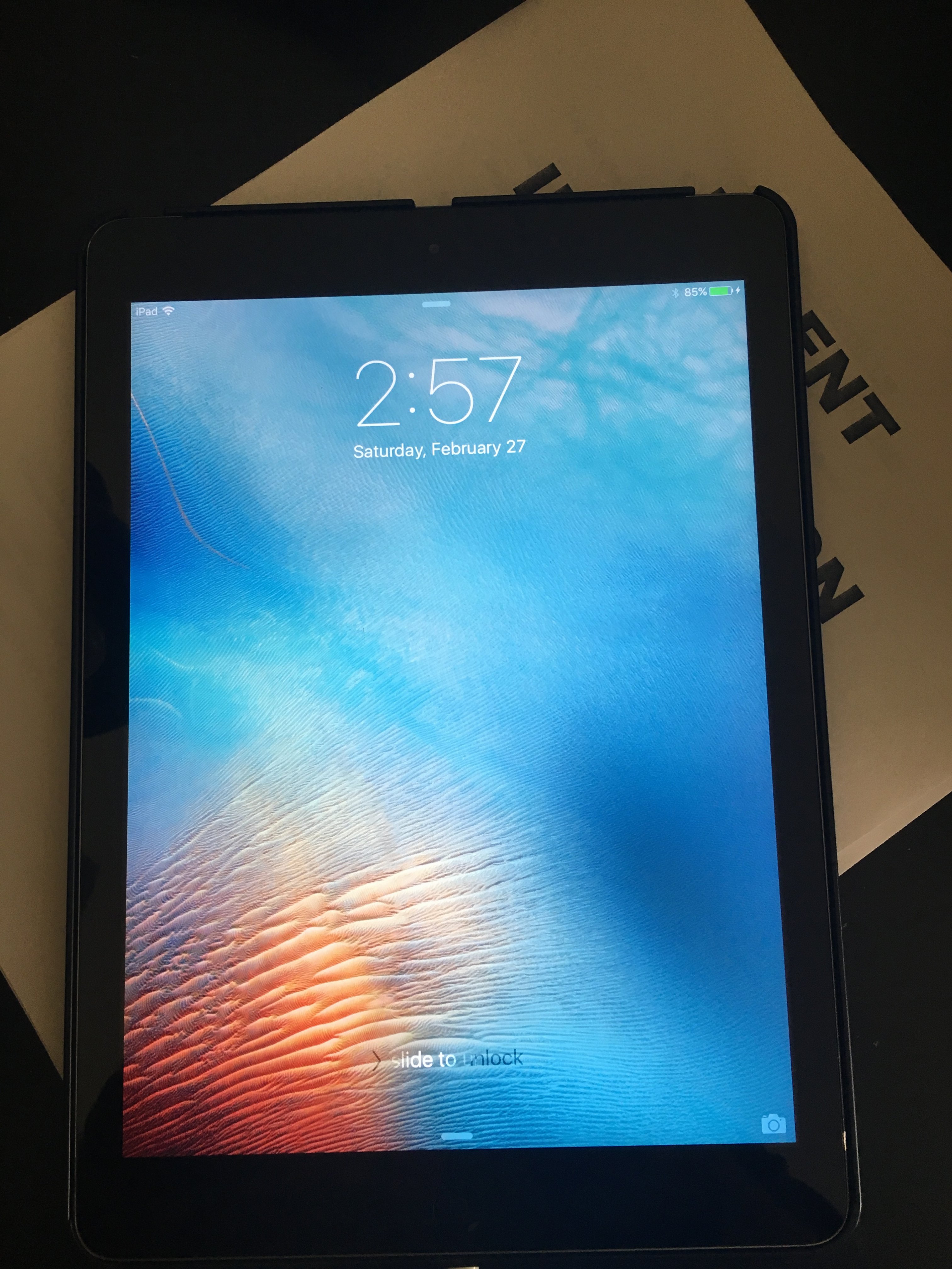

Had it powered back on for almost a week now. Absolutely no indication that it was a popsicle just a couple weeks ago. Battery charges just fine, and drains normally (watched a 2 hour movie and it dropped from 100 down to 80%). Absolutely love this and will look forward to the next iPad to upgrade.
