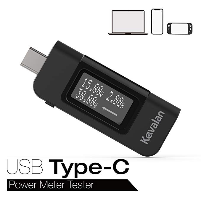

It's hard to test definitively without specialized equipment, but if it's available where you live a Power meter such as https://www.amazon.com/gp/product/B07D316FHM/ can be a convenient way to verify and isolate the issue.
