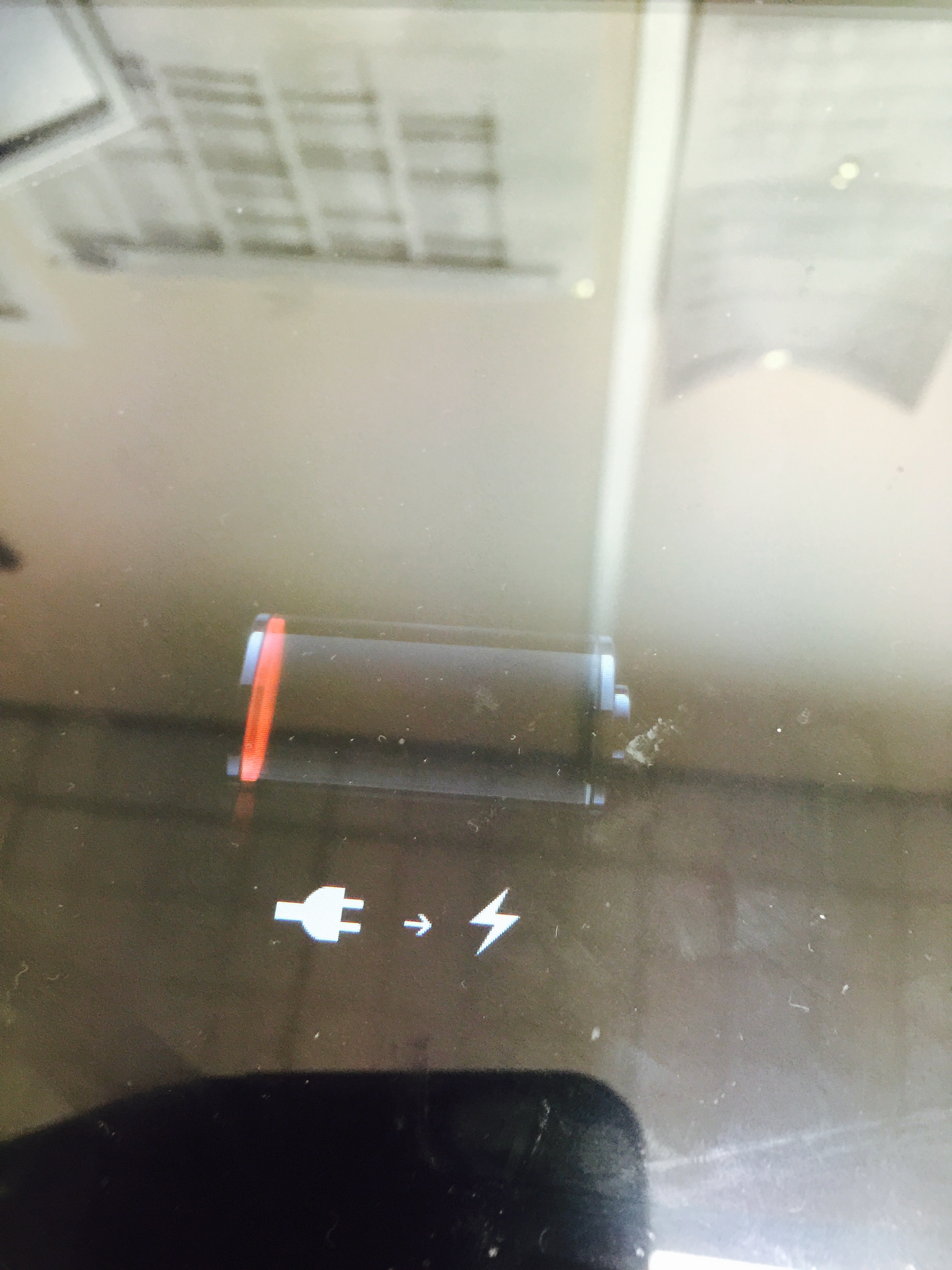

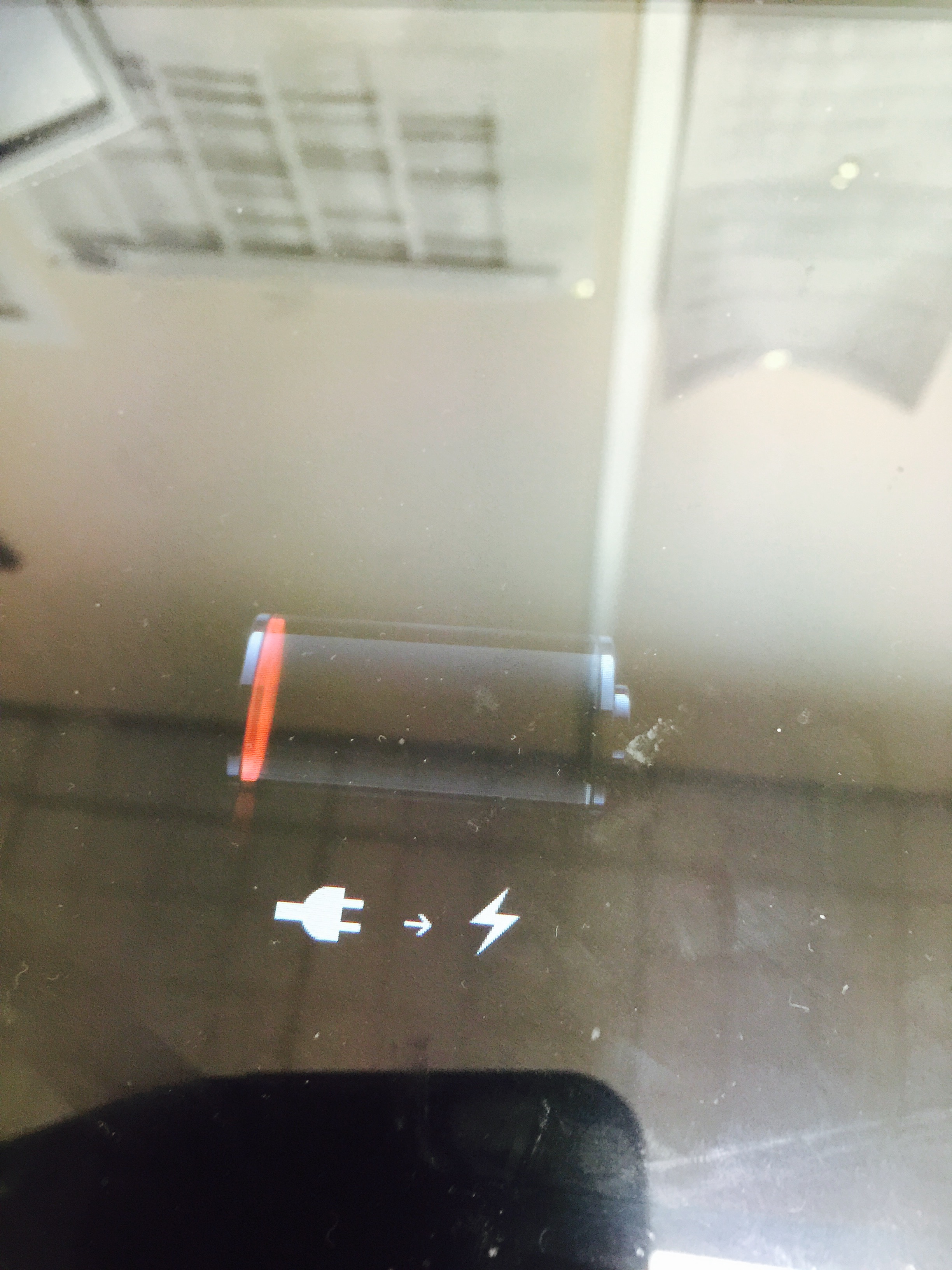

I'm having a similar problem with my iPad 1, when it charges to 100% and it is not unplugged, I get the attached screen and I can't use it, it usually lasts a couple of days and then it can be used again. Any one else see this screen.
Your battery has failed
