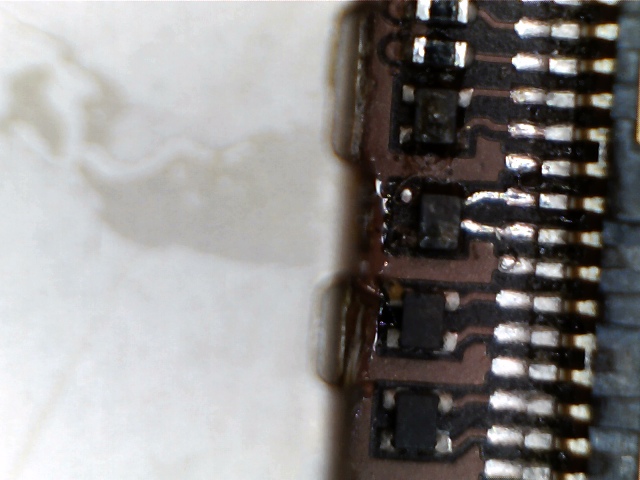

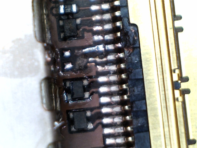

I also have a very similar issue...the digitizer was replaced by someone and now everything works except the lcd shows a green hue. I have discovered that one of the lcd filters is missing and must have came dislodged from the logic board during replacement. After attempting to transplant a filter from an ipod touch 4th generation to no avail, i have decided to sit and wait until i come across a dead ipad to steal the filter from. I have included pictures of the lcd connector with the chip missing and one of the ipod filter transplanted.
Thanks for your information and photos! I took a look at my iPad and, sure enough, one of the filter chips had been torn off. I researched the circuit diagram and found it to be a TCM0605 - SYM_VER-2 90-OHM-50MA
I was able to order a bunch of these from Digi-Key - cheap. Now I have to see if I can solder one onto my board...they are SMALL!
