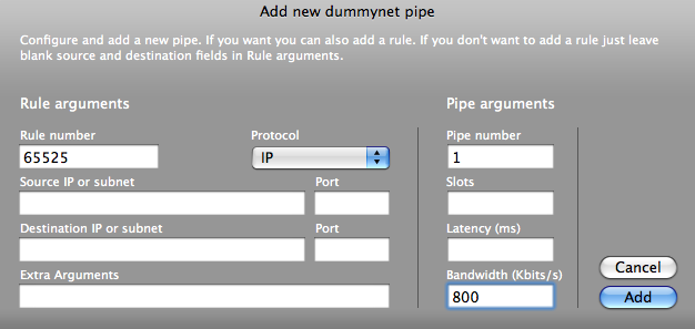

Ok, how do I set it up once I'm at this point:
