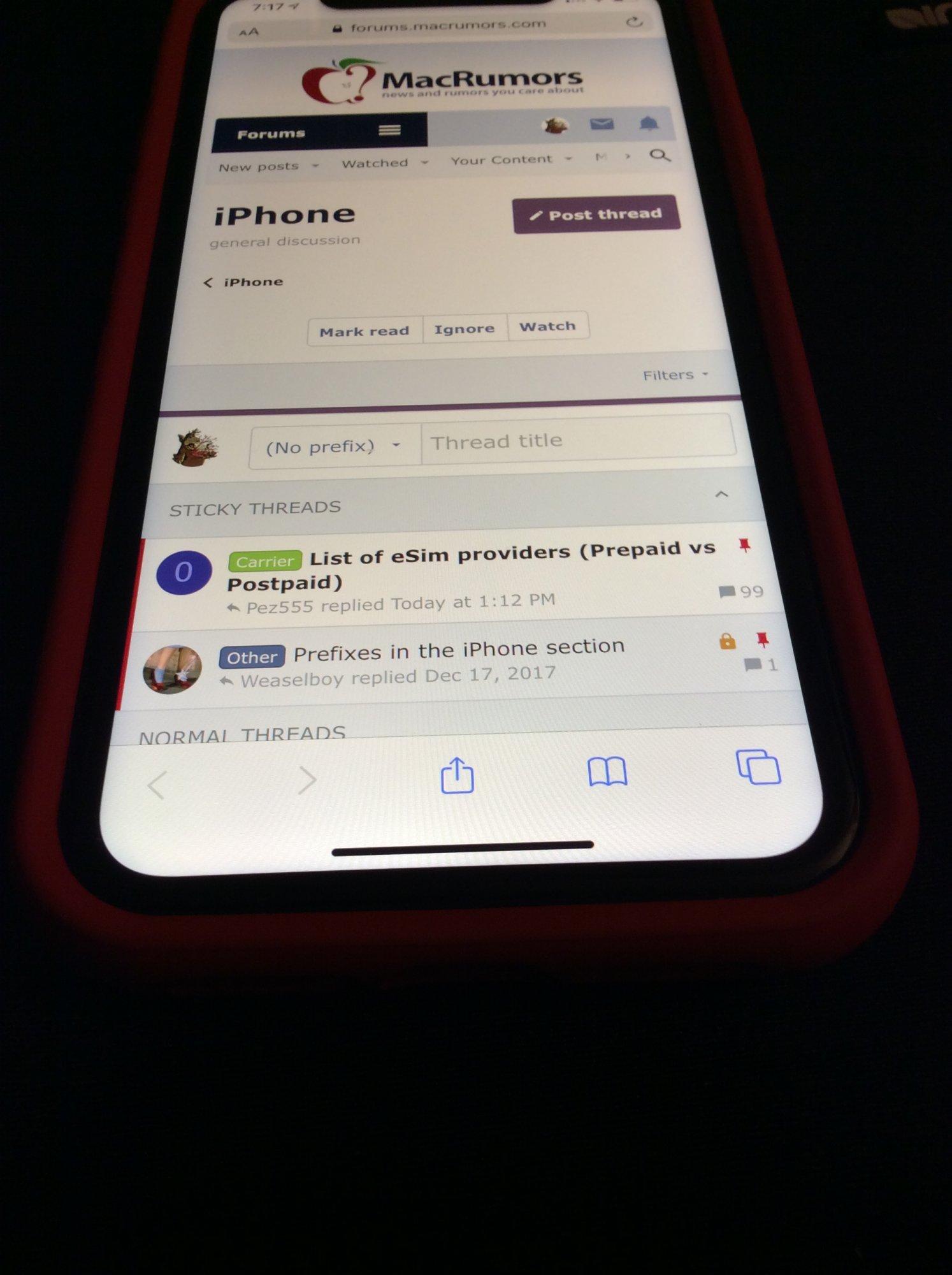

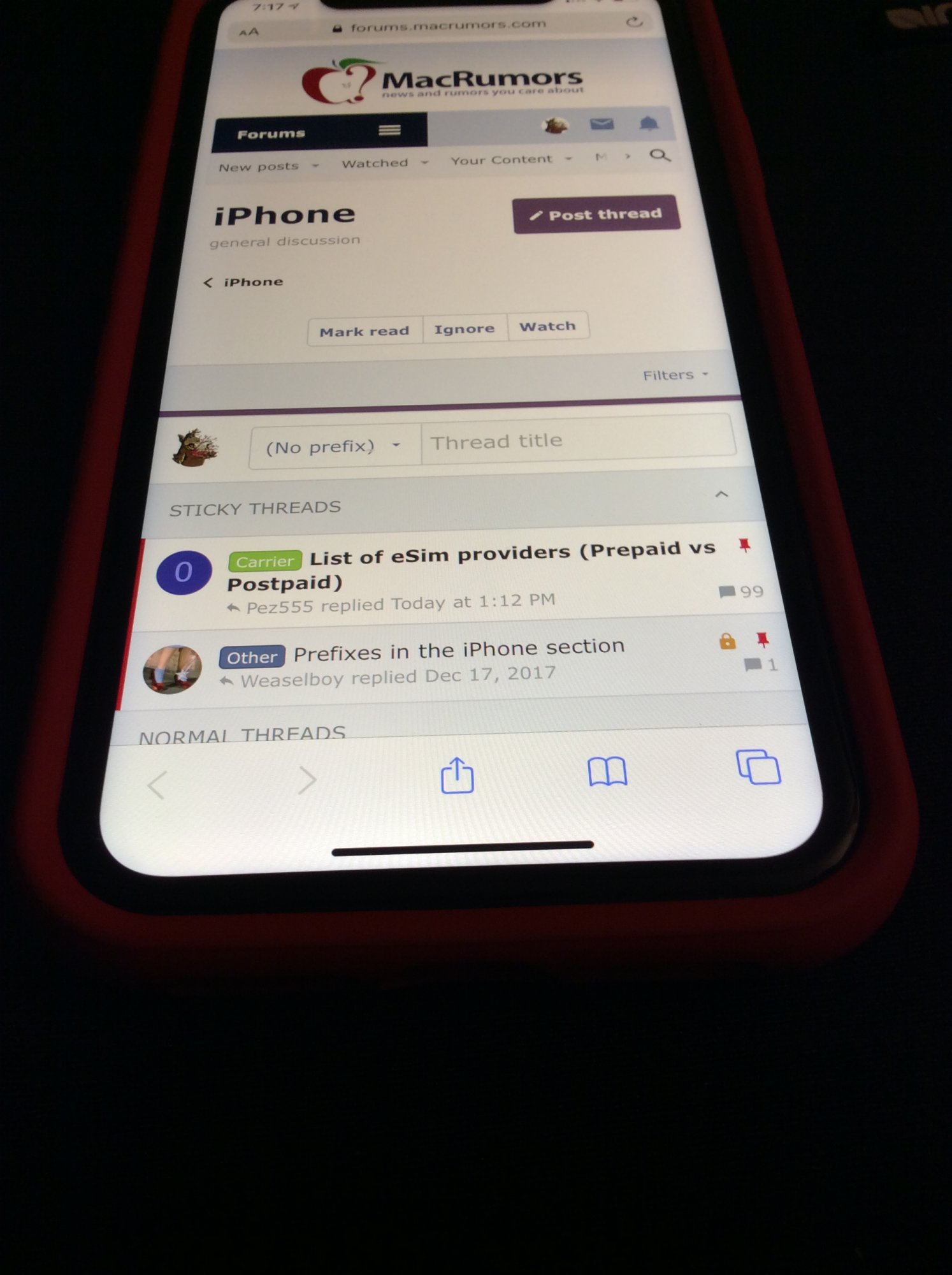

Does anyone else have a shadow around the notch and in the edges of their iPhone 11 LCD? It’s more noticeable on the iPhone 11 than on my iPhone XR. Are these screens cheaper?
yes there is a shadow, is the LCD that can´t bend when it meets the borders.

This is how LCD technology works. In the corners, or around the notch there will be a shadow. some have it, some do not have it. But there is no perfect LCD.

Or maybe you just don't notice it. Brightness and viewing angle impacts this.
It was commonly observed on the XR (My own included). Probably the same on 11.

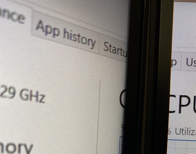

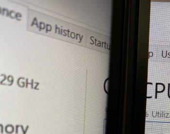

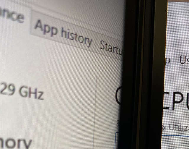

This is an effect that happens on any LCD screen with slim edges/bezels. The LCD screen is made of a stack of layers. The actual image is formed near the top, but the light comes from a backlight diffuser film a distance behind.
Traditionally, the backlight diffuser was extended beyond the edge of the image. To minimize bezels/non-image area, they trimmed this overhang. As a result, when you look at the screen from an angle, you can more easily see past the edge of the diffuser.
This picture shows the effect on a slim bezel desktop monitor. The two are identical models, but the one on the left is viewed at an angle, where the one on the right is nearly straight on.
You can also point this inherent limitation out to those who scream for a bezel-less laptop or iMac screen.
I understand about looking from an angle but the faint shadow is sometimes visible slightly when looking dead on. Would that also be normal to a certain degree?
