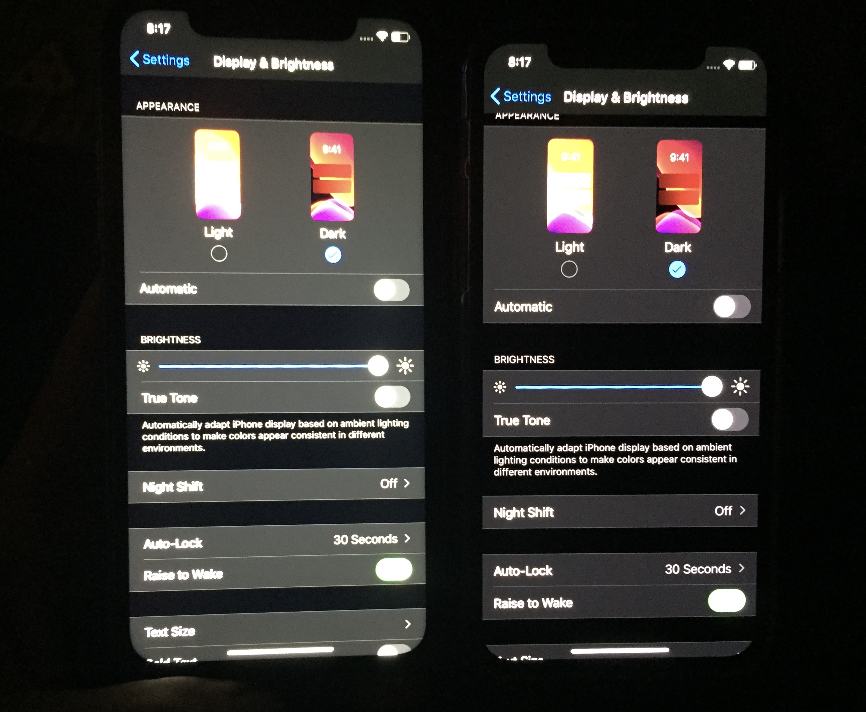

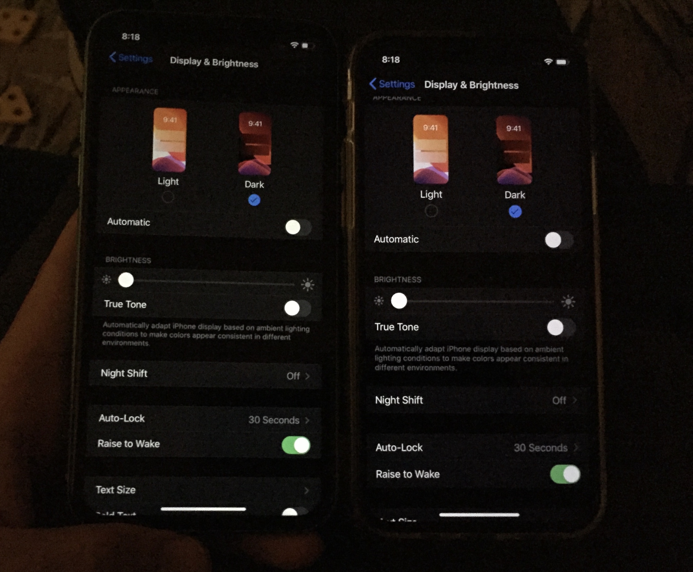

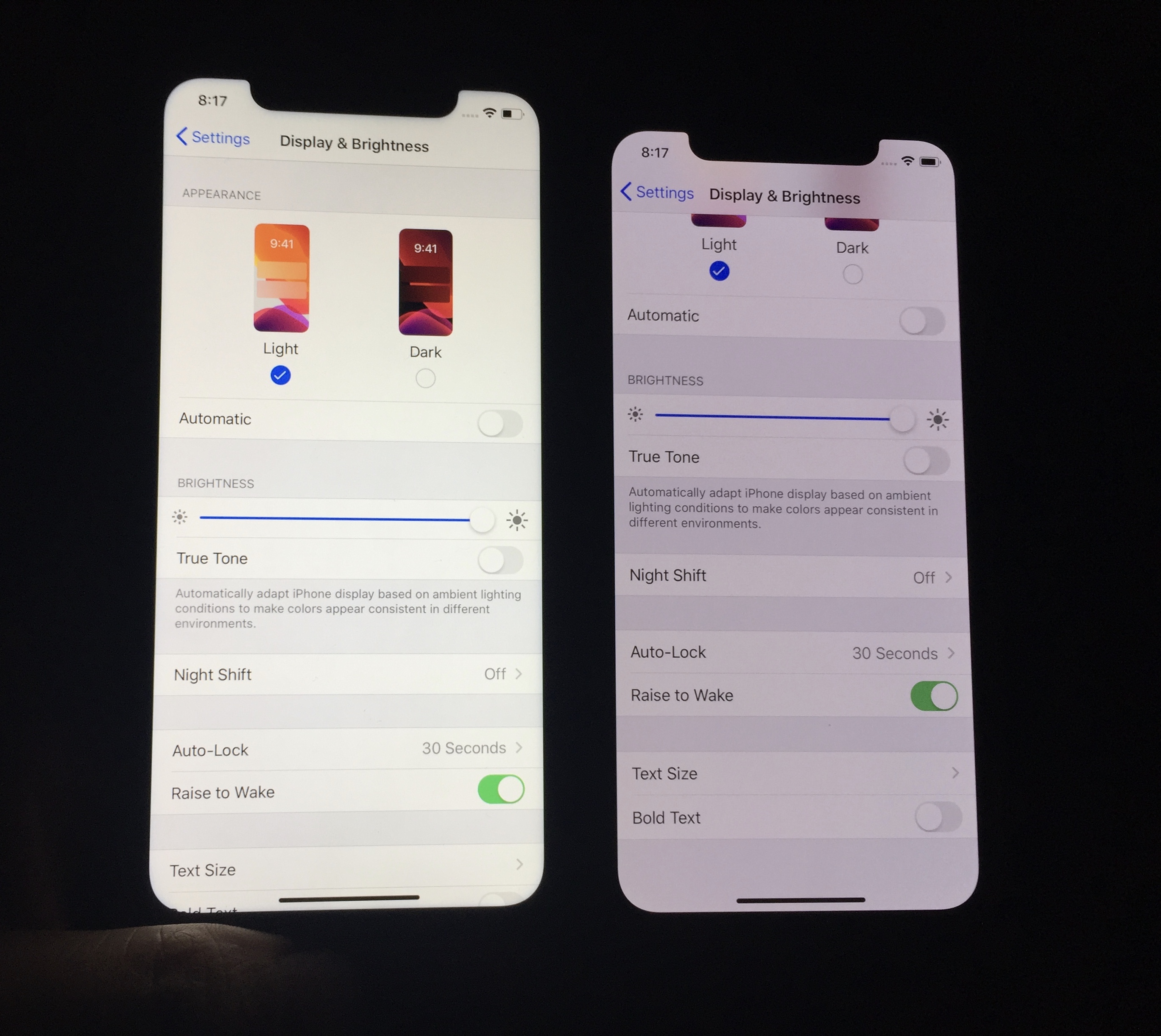

I got both a base 11 and a pro. The pro is supposed to be much brighter now on max but that is not what I am finding at all. The 11 on max brightness feels much much brighter. Here are three photos at different brightness levels. I tried with and without True Tone on and off, which made no significant difference to the results. You may think this is due to the photos being slightly off axis but this is not the case either.
Maybe I just have a broken screen?
All in all this LCD on the 11 feels very very very close to the oled in contrast (even though I know it isn’t).
1503B62C-27B5-4674-A04F-FBA9AA14D550.jpeg1215AF20-6F59-4009-A241-018E2BE929AF.jpegCACD46AB-D5D5-4CD2-A20E-B42201DE22F4.jpeg
Apologies for photo quality. I was using my outgoing iPhone 6...

Wow, that's no bueno for sure. Thanks for sharing! I'll be interested to see what comes of this...
Did you go to Settings->Accessibility->Display & Text Size->Toggle off Auto-Brightness (very bottom) ?
Yes you were right. This was the issue. Now it is much brighter. However, what is the point of this setting separate to the other auto brightness setting?
I have no idea why it's turned on by default. Leads to a lot of people thinking their screens are defective.

@OP, if turning off AB (at less than 100% brightness) increases your brightness, it means your Ambient Light Sensor is defective. Go to Apple.
Reactions: jbachandouris

This is a completely flawed test.
The problem isn't that its not brighter, it's that the LCD has much worse contrast than the OLED, so UI stuff that is supposed to be dark now looks bright when you turn the backlight all the way up.
If you want to compare brightness, compare a pure white screen, not some random UI elements.
