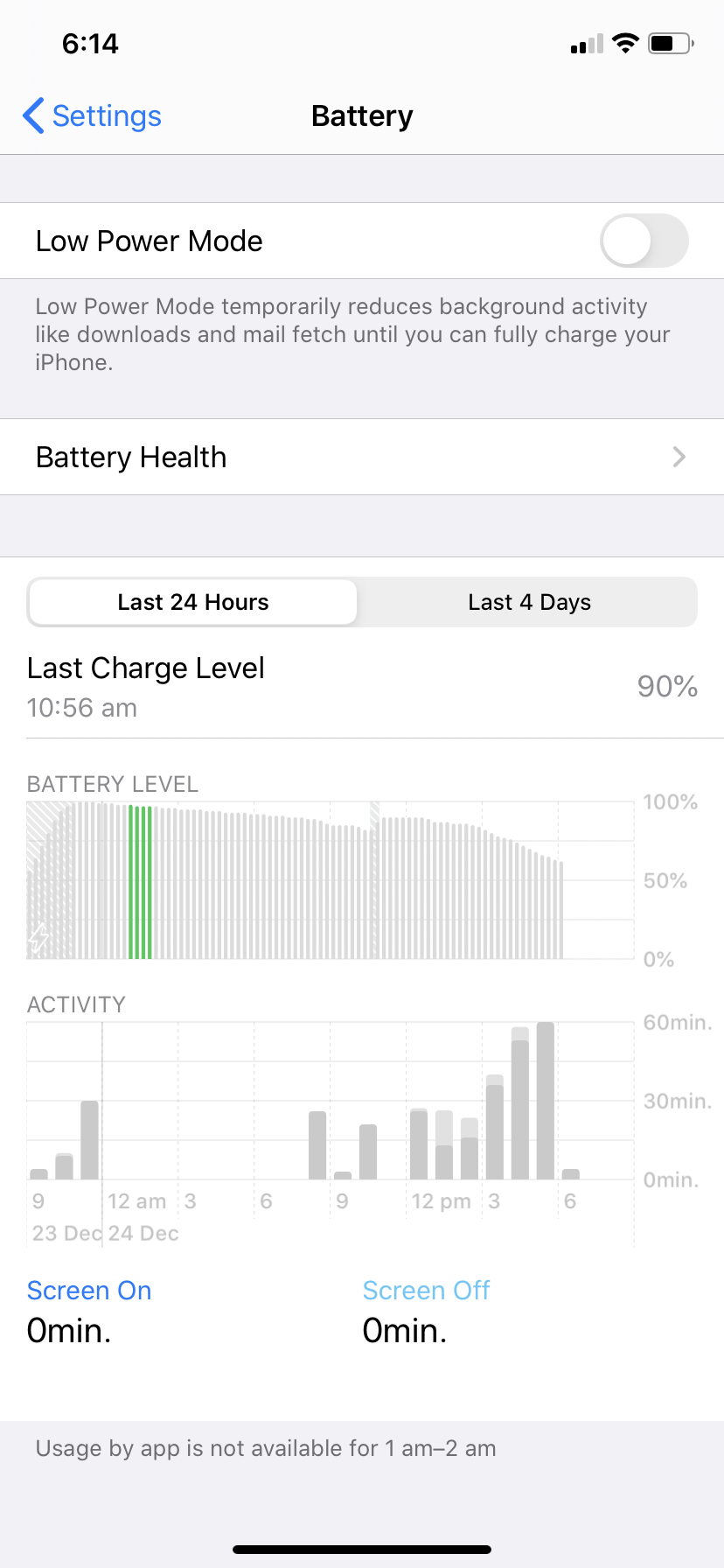

I got the iPhone 11 last week and been a little concerned about it’s battery drain. Currently on iOS 13.3 and it drains about 1% perhour in standby/not in use and that leads to around 9-12% drain overnight (I usually sleep around 8hours). I’ve been checking it for a few days now and didn’t think this was normal considering my iPad barely takes 1% overnight but did think phone would take more considering it has cellular.

Check your Battery section under Settings and see if it can give you more clues?
Yeah that’s the first thing I did unfortunately it just shows usage app not available between the times and just blank but battery graph looks like it’s going down.

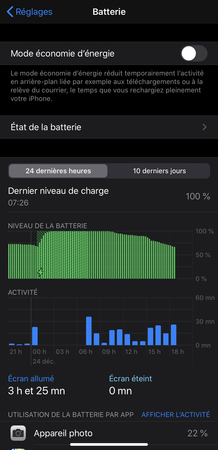

What I find strange on your battery graph is those grey bars, mine are all green, like this, for example:
It is in French, but you should see what I mean...
oh,they were grey because I made a selection on one of the times to show that it says “usage time not Available at the times “.

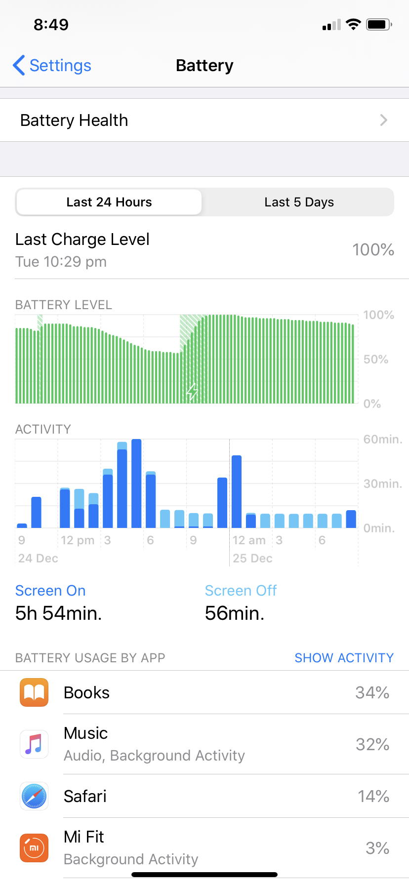

Also an update, I turned on airplane mode but with wifi and bluetooth on last night but didn’t force close all apps(forgot to do it) and it shows something interesting this time. It seems that it might’ve been my fitness tracker and its app draining the battery since it still drains about 7% overnight. I’m going to try again tonight with same thing but after removing the app.

Also thanks for all the replies and suggestions! It seems that the battery drain was because of an app for my fitness tracker. Even after disabling background refresh and force closing it, it still seems still running in the background. I’m assuming its just checking for notifications to send to the smartband, since it doesn’t seem to sync information like steps and heart rate when forced closed. So I tried uninstalling it to see if I get the same battery drain overnight (with airplane mode) and seems have worked as it shows 0% drain. I’m sure with cellular it will drain some but would probably be less than 1%/hour.
