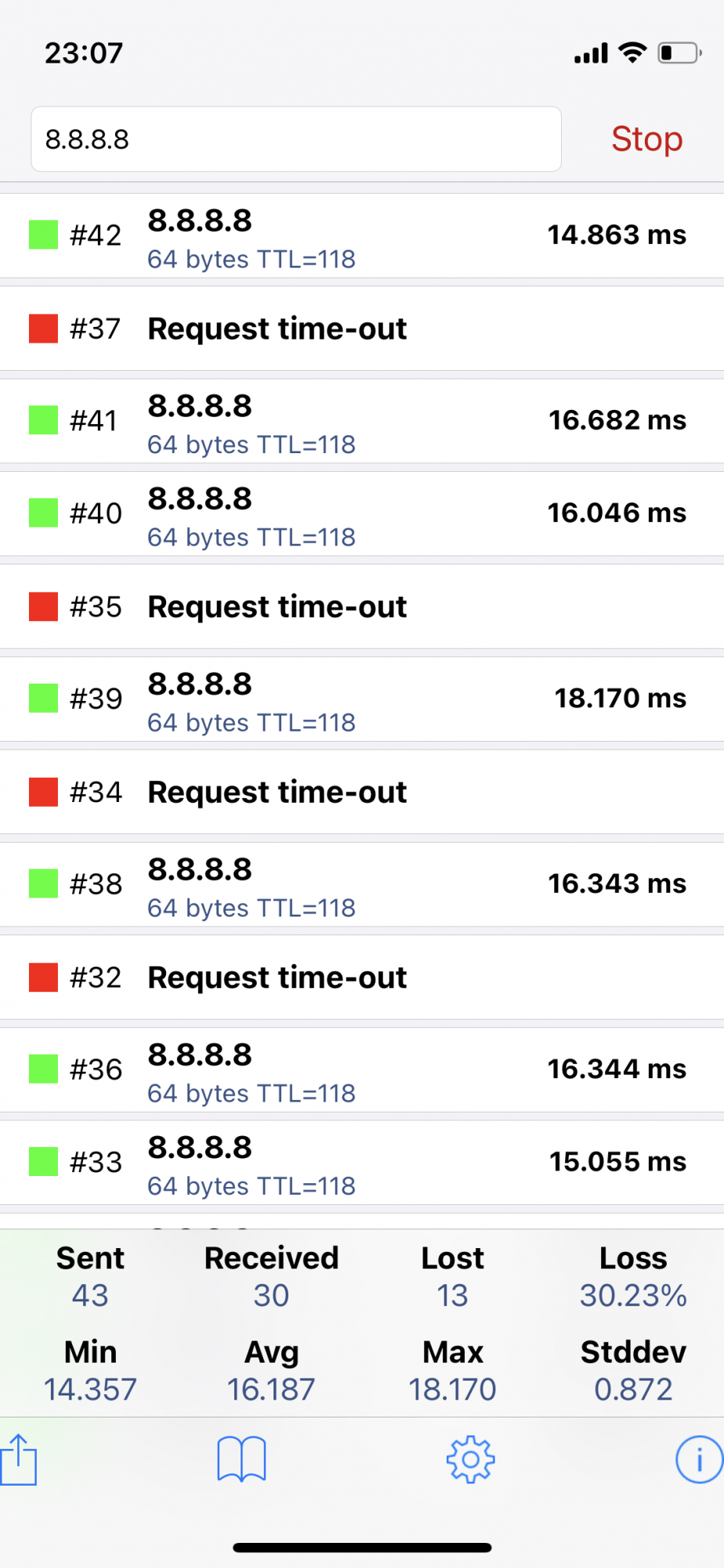

What app are you using?

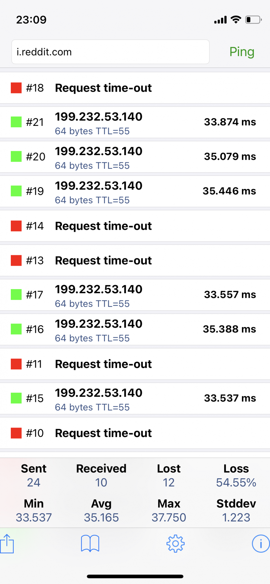

I’ve attached my screenshots. I’ve tried using two apps, one called Ping and one called Ping Lite.
My experience is, for example, typing in a URL to safari and then waiting 5 seconds till something starts happening. Or scrolling through the Reddit app and images not loading.
