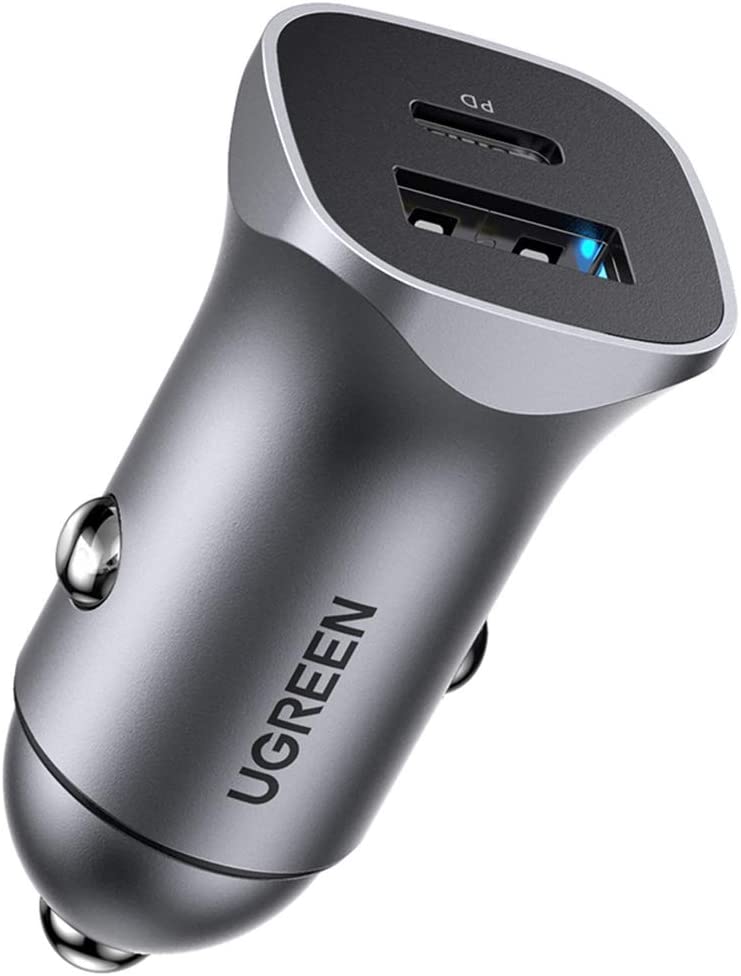

As expected my MagSafe charger will not charge through a USB-C to USB-A adapter with my MFi Monoprice USB-A car charger.
So, I picked up a ugreen USB-C PD + USB-A car charger and the MagSafe charger works fine through that... sort of.
If I plug in the MagSafe to the ugreen car charger and leave the charging phone on the seat, it charges fine. (Note, I picked an Apple leather Magsafe case so now the magnetic attraction is strong.) However, I can magnetically attach the MagSafe charger to my pre-existing magnetic phone mount, and the connection is strong.
However, if I do this, the MagSafe charger no longer works. It says it's charging but it periodically loses the connection temporarily, or else loses it completely. And it doesn't charge, or at least not to any significant amount, so that if I'm using it while it's attached that way, the charge will actually deplete. I took the MagSafe back off the magnetic mount, and again it charges my iPhone just fine.

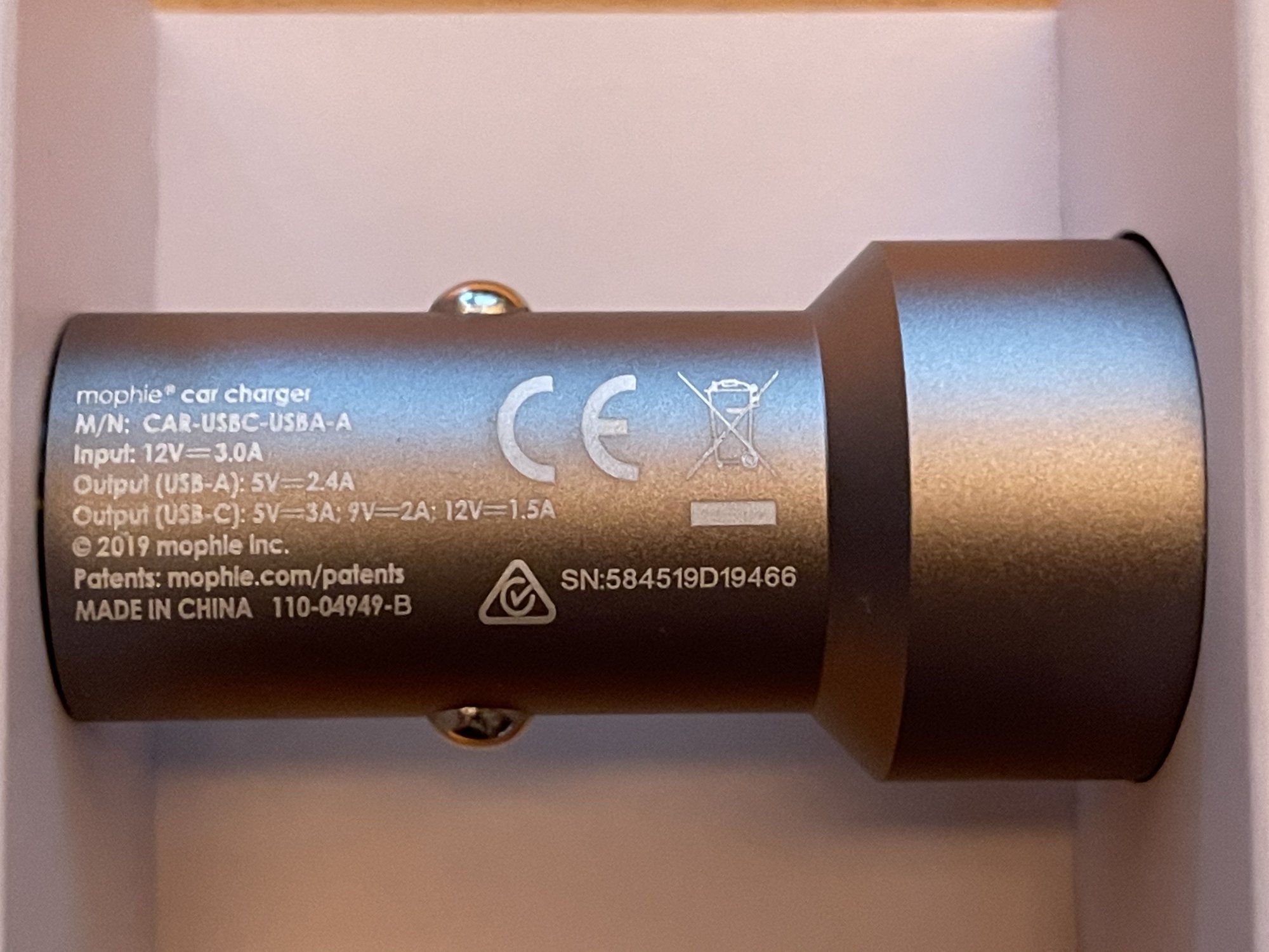

Hoping it was just due to some weird third party incompatibility, I went out and bought the Mophie USB-C/USB-A car charger from the Apple Store.
HN822
It appears to keep the connection longer, but still periodically loses the connection for a split second. However, it never completely loses the connection. Does this mean it works better than the ugreen? Unfortunately no. It also does not charge that way. Again, the only way it works is if I remove the MagSafe charger from the magnetic car mount.

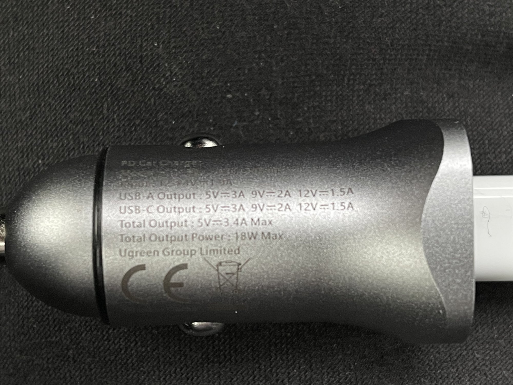

The Ugreen power adapter I mentioned above is a 18 Watt dual USB-A/USB-C charger with USB-C PD 3.0. I didn't measure max output, but it seems fast with the MagSafe charger.
However, this guy measured it at 12.x Watts, but then says it's 18 Watts somewhere else in the review:

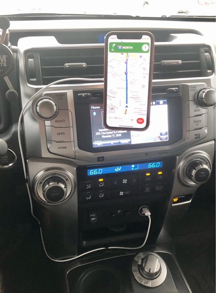

I use this AUKEY Car Charger and it works really well with magsafe. It says it supports up to 30watts if only the usb-c port is being utilized but have not tested it. I will say it charges MUCH faster than my old USB-A car charger.

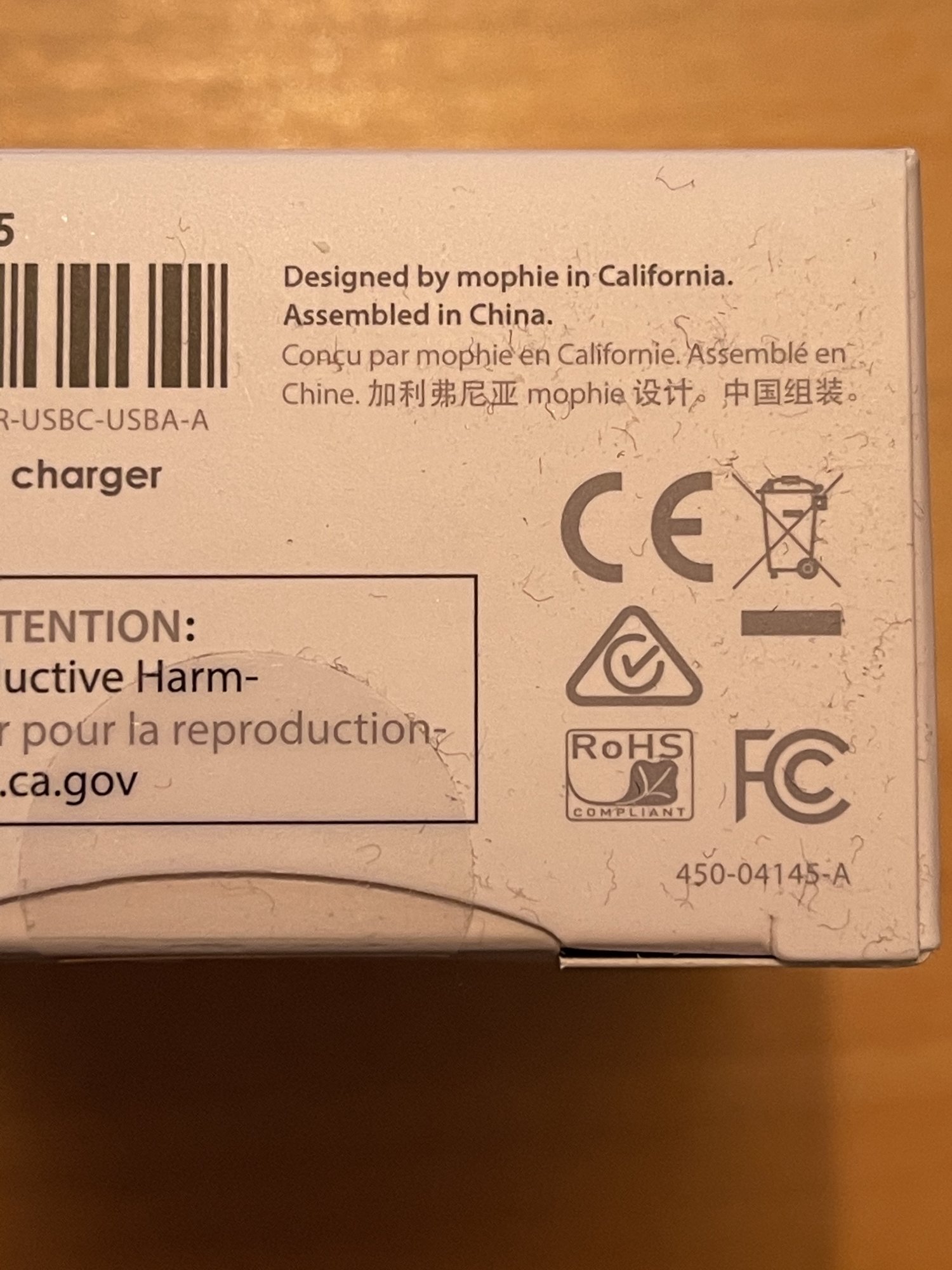

Off topic, but could you please tell me if that Mophie charger has the UL certified stamp on it? Or if you could take a picture of the the side of the charger with the seals and voltage information it.
Mophie:
Ugreen:
Reactions: nmeed
Mophie support told me it’s UL certified and based on that I purchased it. Oh well. Thank you.
CE + FCC not good enough?
But no, it doesn't have either UL or CSA logos anywhere as far as I can tell.
EDIT:
So I just looked this up. You generally don't need UL certification if it doesn't plug into an AC outlet.
Reactions: nmeed
Glad it works for you, although it blocks your screen. I am personally not a big fan of vent mounts and I also have the main vents above my screen so I didn't want to go with something like that for those reasons.
BTW, it turns out the Belkin MagSafe vent mount doesn't actually have a charge function anyway. Lame.
Well this is a iOttie magnetic CD mount that I attached my magsafe to. If I use my phone in landscape mode, it does not block my screen (which is pretty useless anyway besides the backup camera)

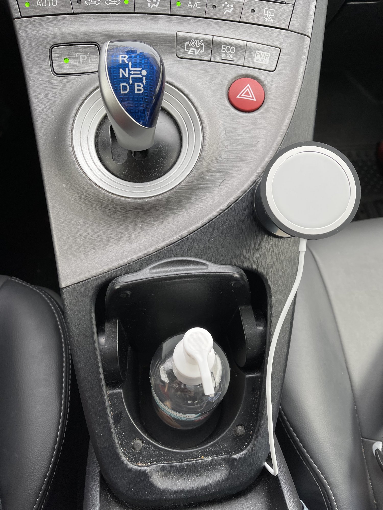

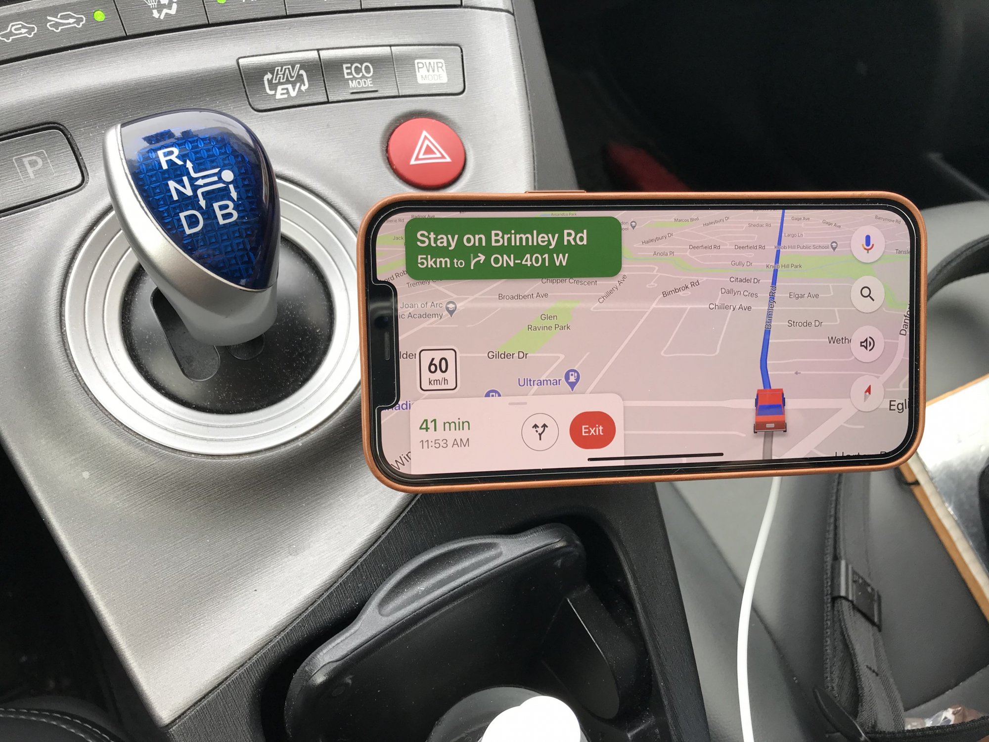

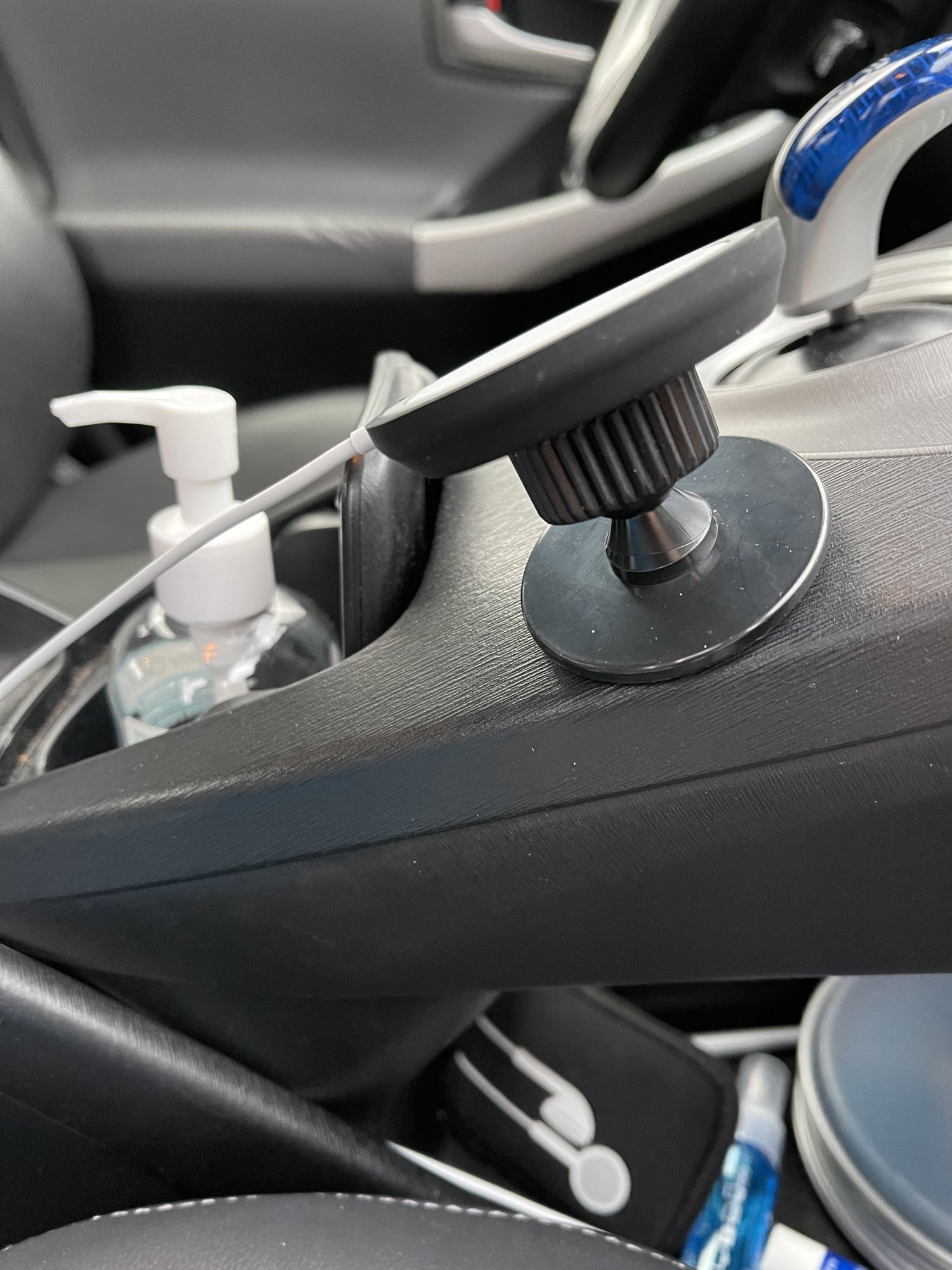

I got the above mount from AliExpress recently.
To my surprise, this mount works really well. Yes it's cheap and doesn't have great looks, but nonetheless it works. The mount base is firmly attached to the surface on my dash even though the dash is somewhat rounded. The round soft holder in which the charger is placed is soft enough to come right off the mount easily but in real world usage it is strong enough to hold the weight of the Pro Max firmly without even a hint of it wanting to come off. Note that mine is one at an angle and not vertical, but I think it would work fine vertically also. The only issue is that the charger is held in place in that soft round holder not by the edges of the mount, but by an adhesive sticker inside, so you need to have the charger dedicated for this purpose.
Also, if you want to change the orientation, instead of turning the mount head, all you have to do is lift off the phone and re-orient it.
You can also just turn the whole assembly, but this is not ideal because it moves the charger cable too. If you look at the picture below, I had turned the phone from portrait to landscape but that pushed the charger cable to the right. That wouldn't work if the cable was tight though. I have since run the cable along the seam of the dash panel so it can't move like this, so to move the screen like that I have to lift it off and put it back, which is fine.
BTW, it turns out the Belkin one I mentioned before isn't actually a charger. It's just a MagSafe mount, so that wouldn't have been useful for me anyway.

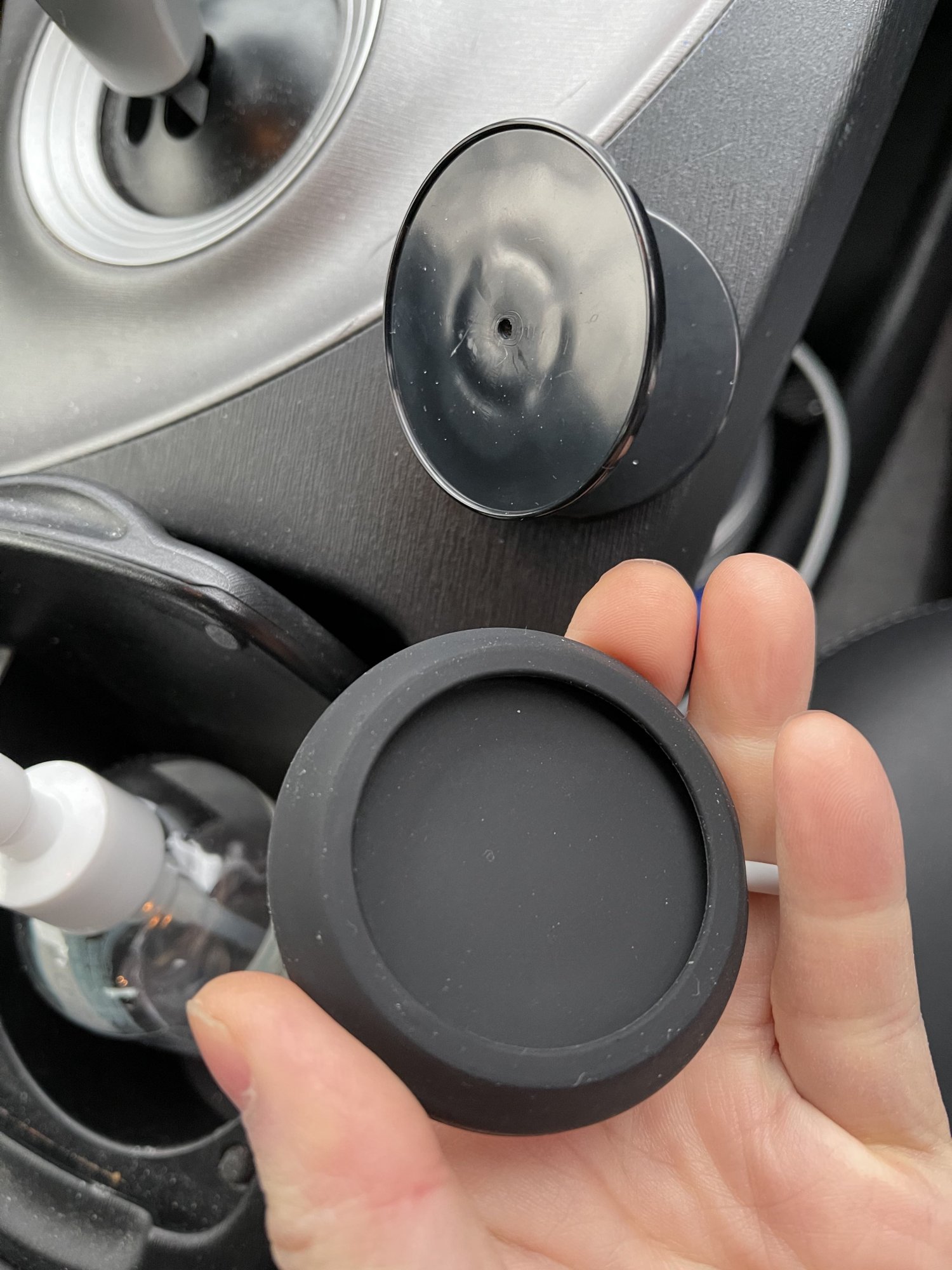

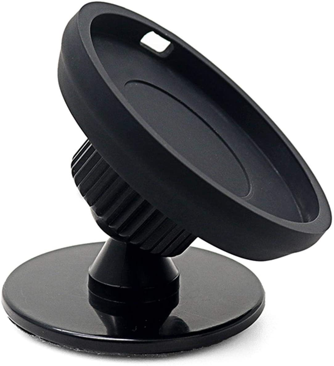

Side view:
Charger holder removed from mount base:

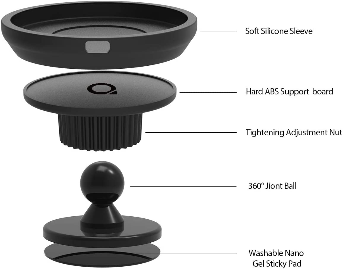

The actual charger is on the other side. I'm showing you the bottom. This whole piece is flexible, and the rim on this side is what holds it to the mount base. As I mentioned, it's quite soft but it still holds quite well.
Here is the Amazon pic showing the different pieces:
