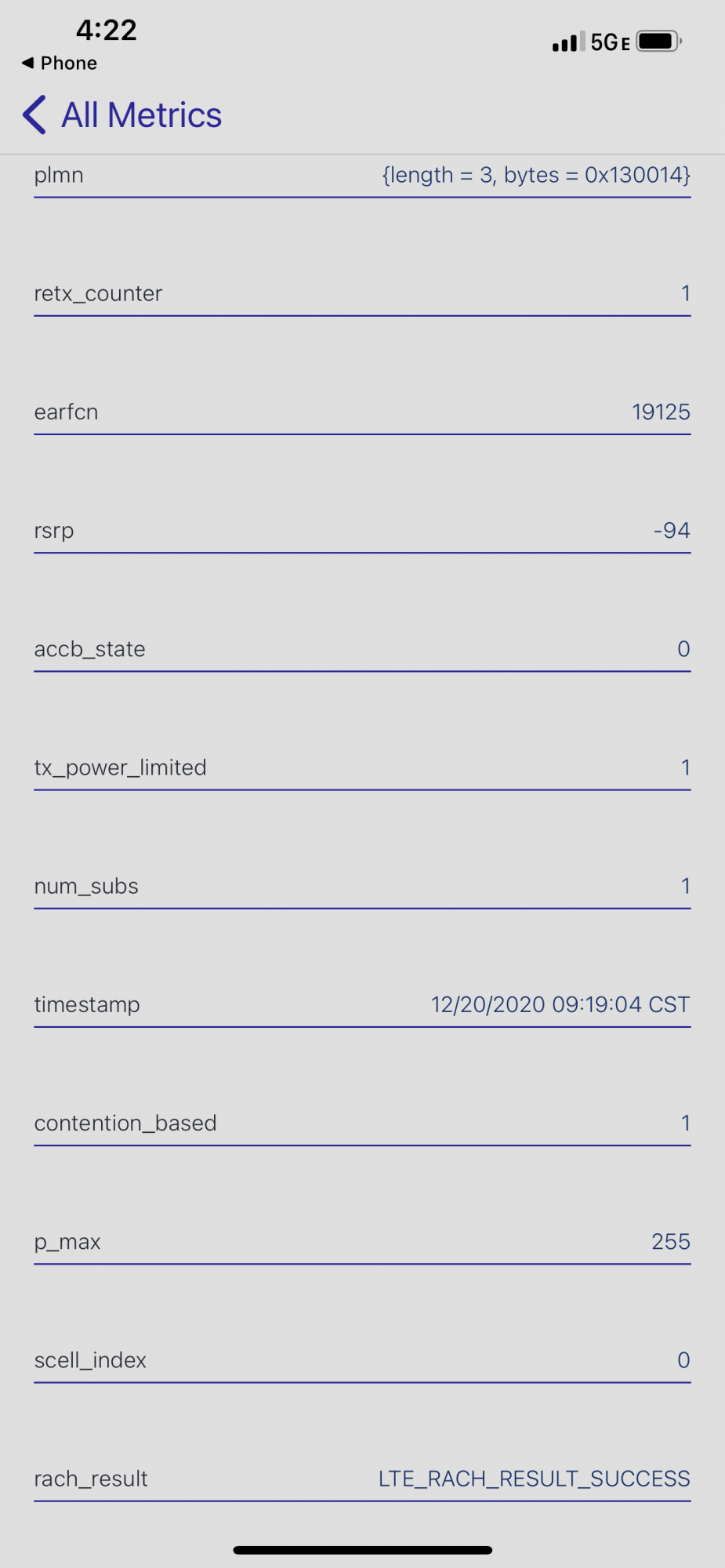

Right now, it’s showing -94 with 3 bars. Below is screenshot.
EDIT: Makes no difference with wifi off for me, but here is another screenshot:
