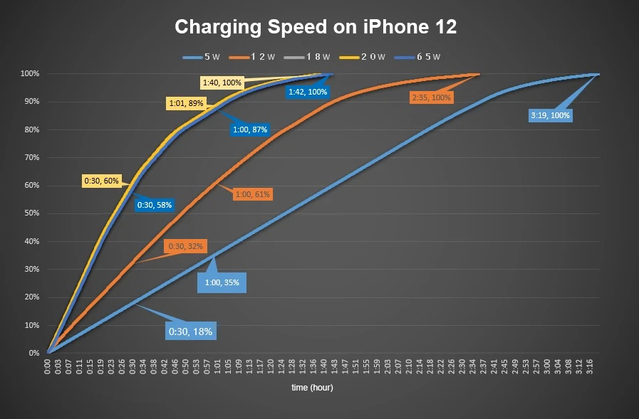

Found it: https://www.phonearena.com/news/Yes...ne-12-as-fast-as-the-new-20W-charger_id128212
From the website:
I'm assuming you already know the whole spiel about how rapid charging is a bit more stress on the battery and can affect longevity - so if you don't have to, it's recommended to charge slower if you can manage it. Within a 2-3 year usage timeframe it shouldn't have a huge impact (imo).

No, it does not charge faster. Here are my own personal numbers.
fast charge using 87 watt macbook charger for iphone 12 pro max
15 minutes - 30%
30 minutes - 59%
45 minutes - 78%
1 hour - 88%
1 hour 15 - 93%
1 hour 30 - 96%
1 hour 45 - 98%
2 hours - 100%
similar numbers to https://www.phonearena.com/news/Yes...ne-12-as-fast-as-the-new-20W-charger_id128212
