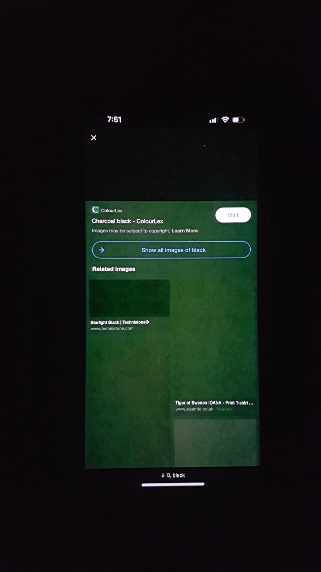

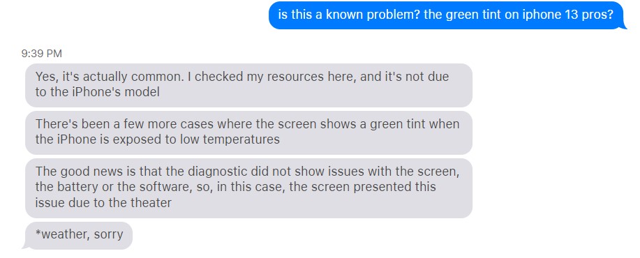

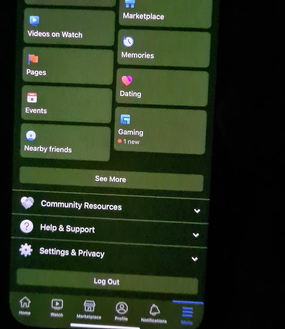

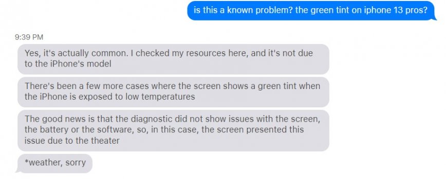

I noticed the same thing while I was out walking today, it was around 3 degrees Celsius, and I noticed the problem happens at very low brightness only, as soon as I turn up the brightness, the problem disappears lol. I asked Apple Support and they had a few cases but they say it is normal, so idk. Side note: It actually looks much worse on camera than in real life, but it is definitely noticeable if you look for it.
Our diagnostics didn’t show any issues. 😂 🤣🤣
