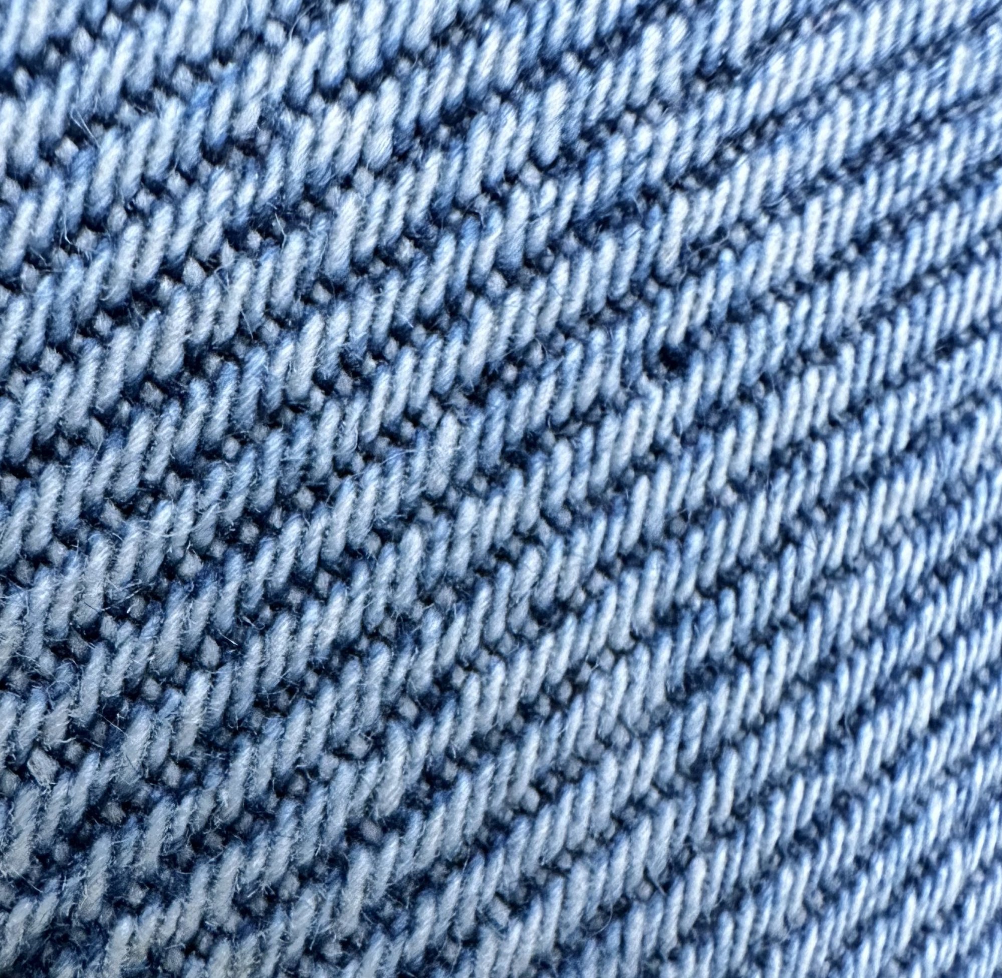

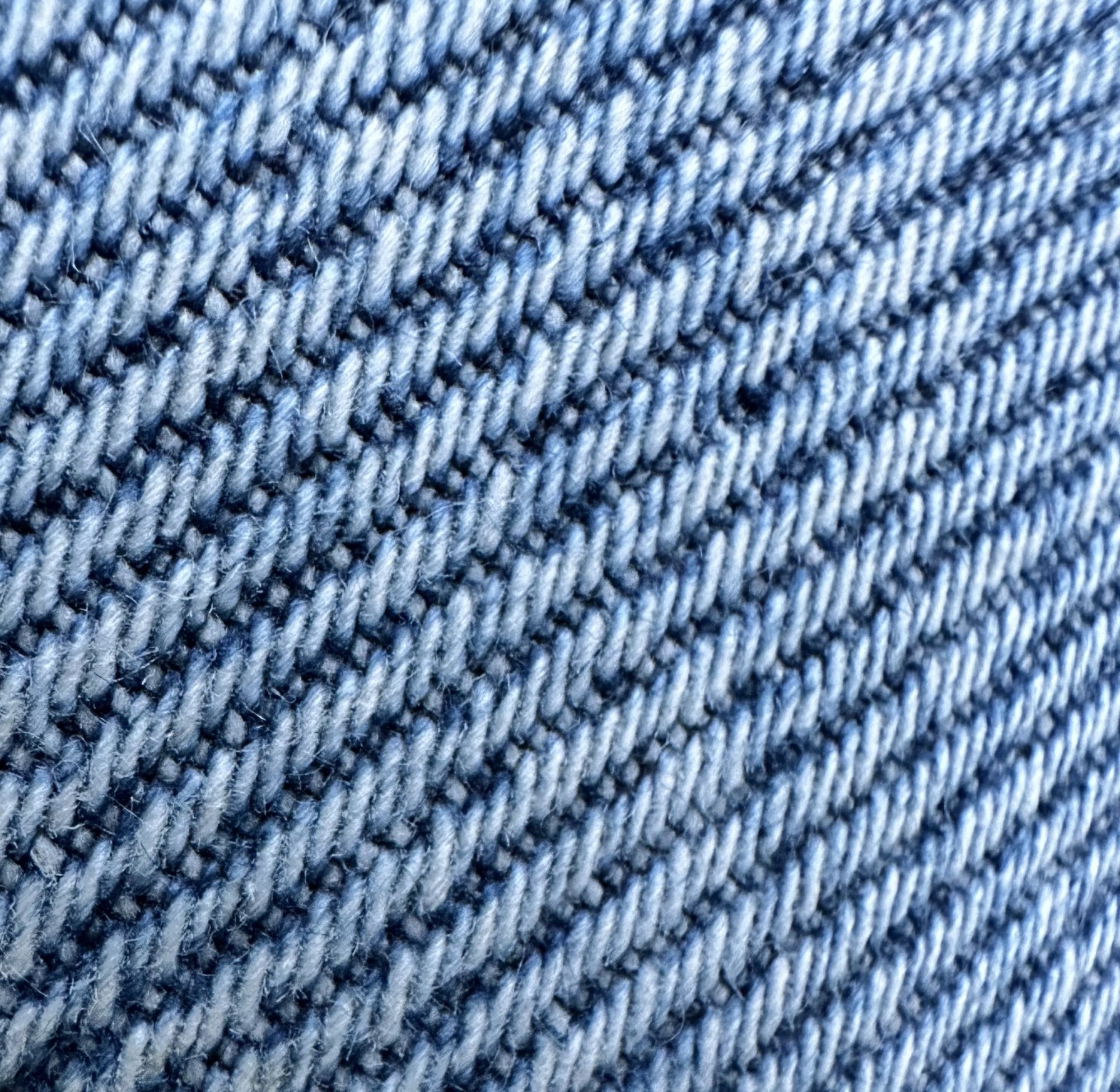

Just took this. Denim jeans, 1” distance.
iPhone used ultra wide lens.
As to bar codes have not had issues with focus/reading of them.

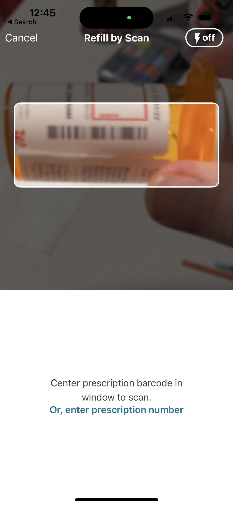

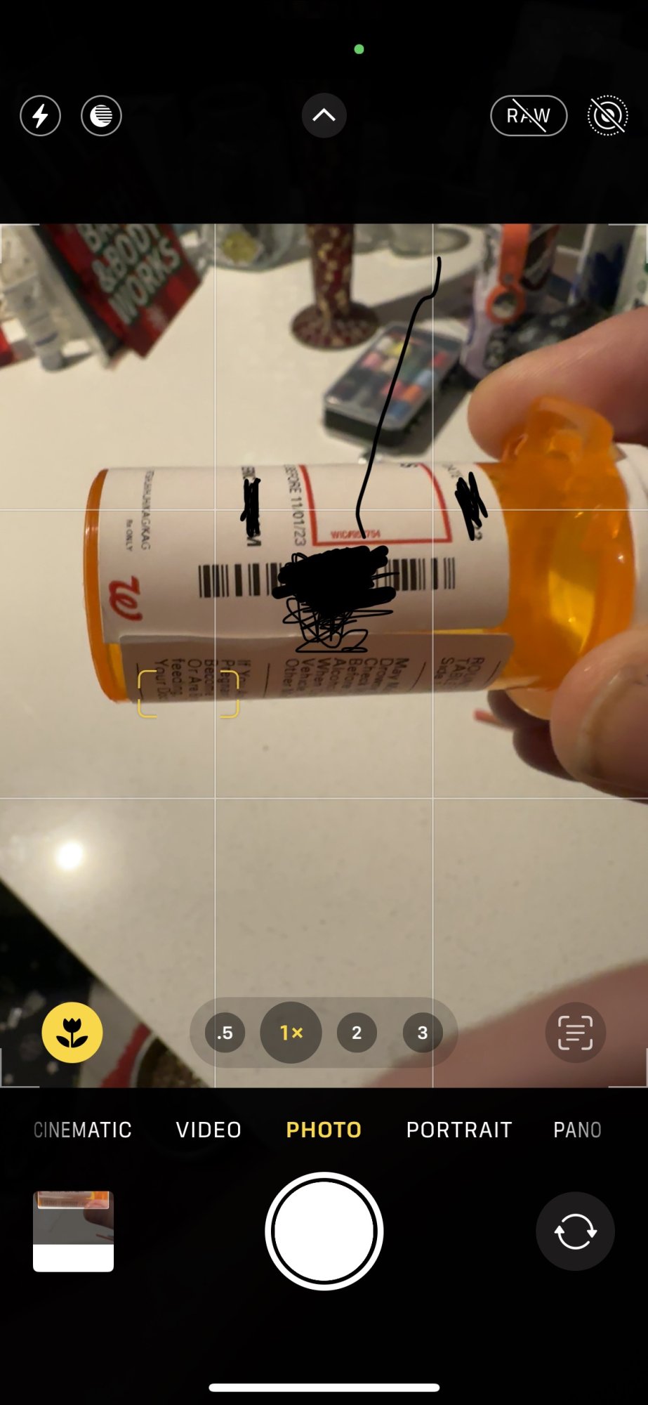

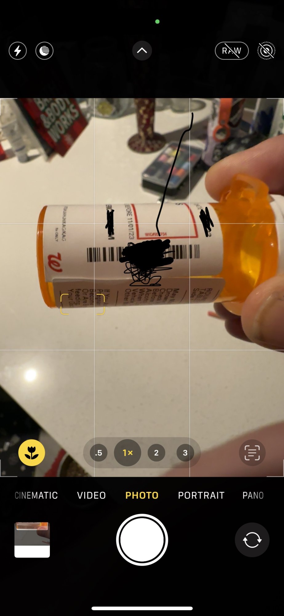

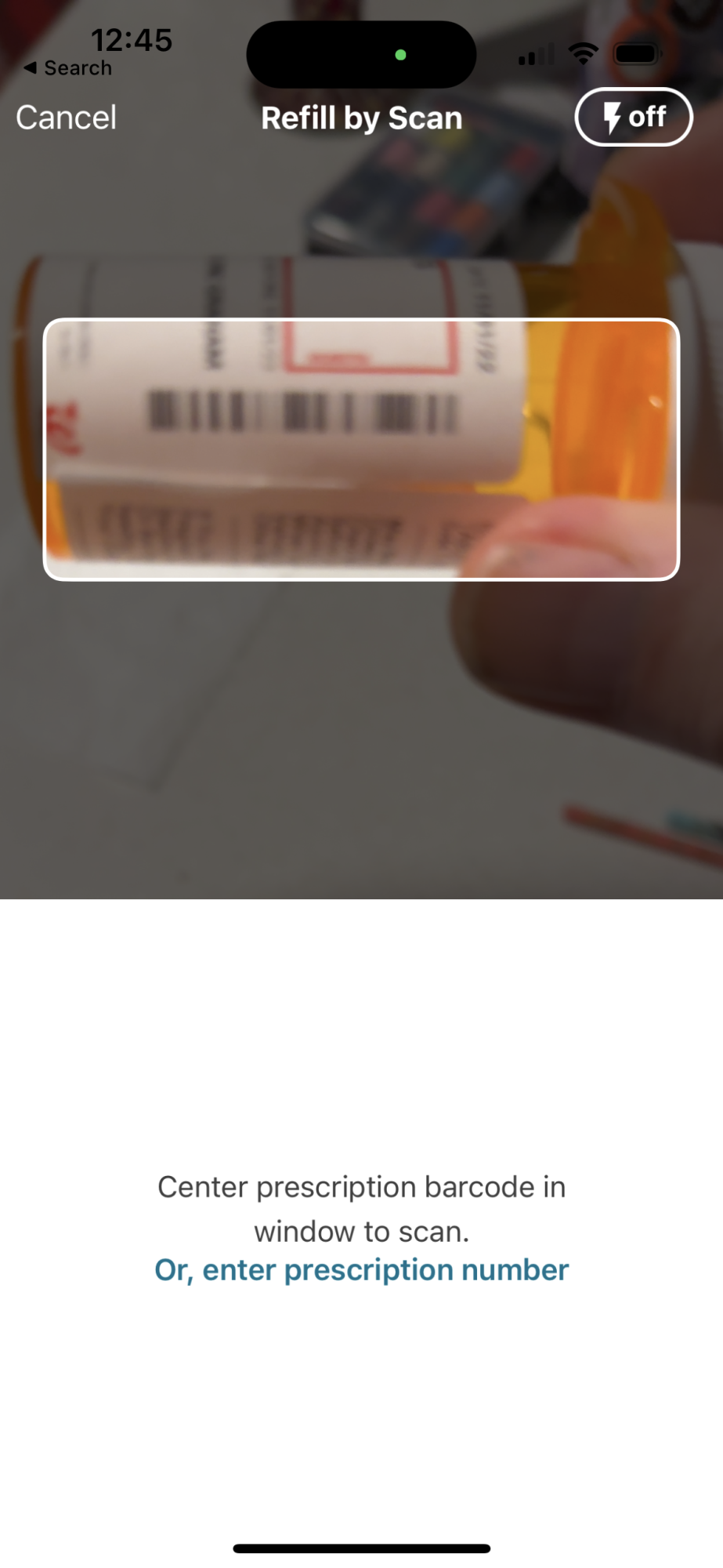

Wanted to chime in that I am also having these problems. The Walgreens app won't scan a barcode, and the camera indeed switches to macro mode when I use it from about the same distance. This also prevents Saucey from scanning the barcodes on the back of my ID.

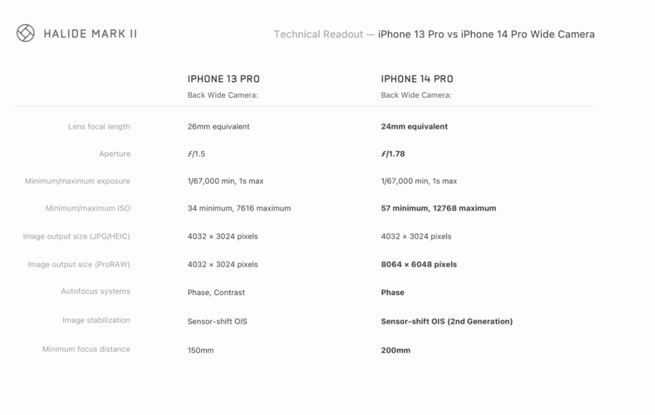

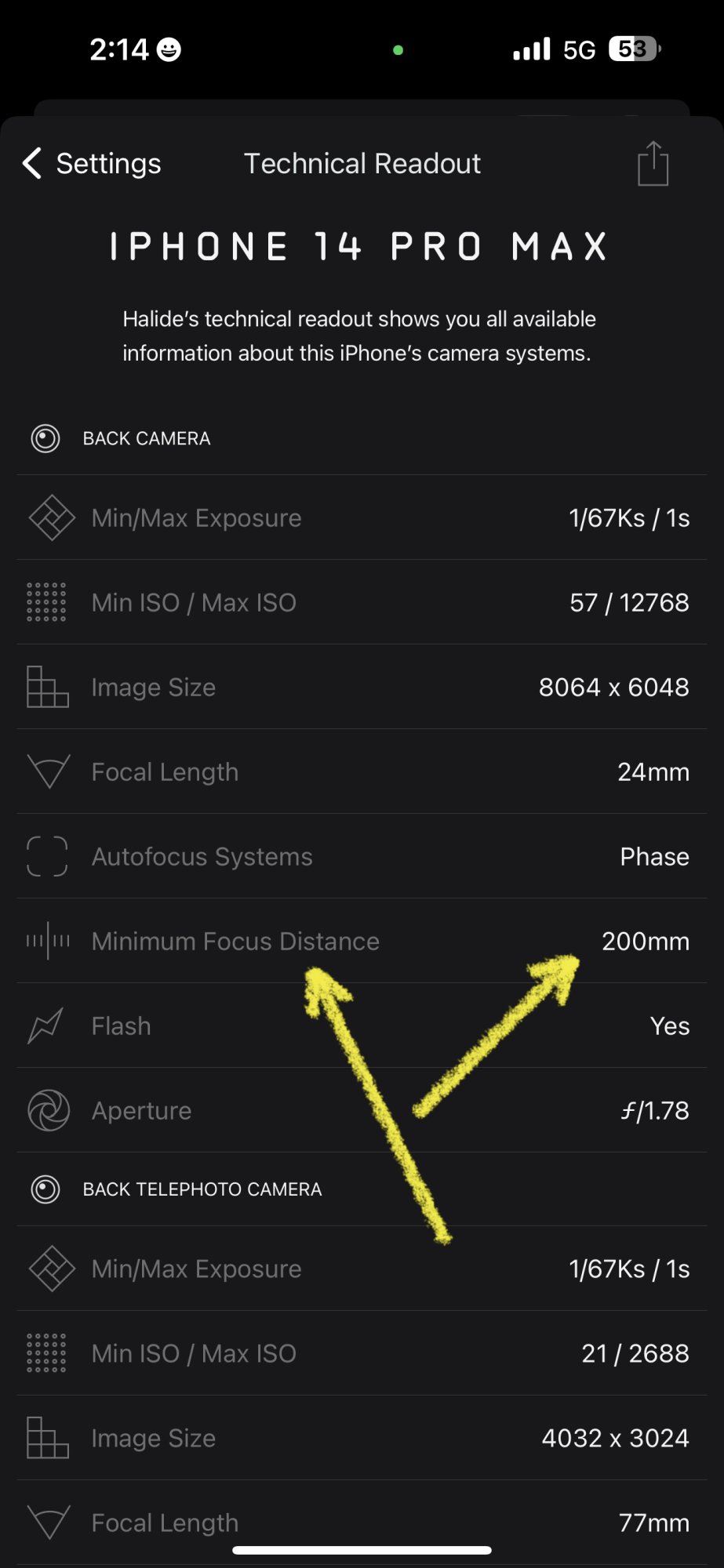

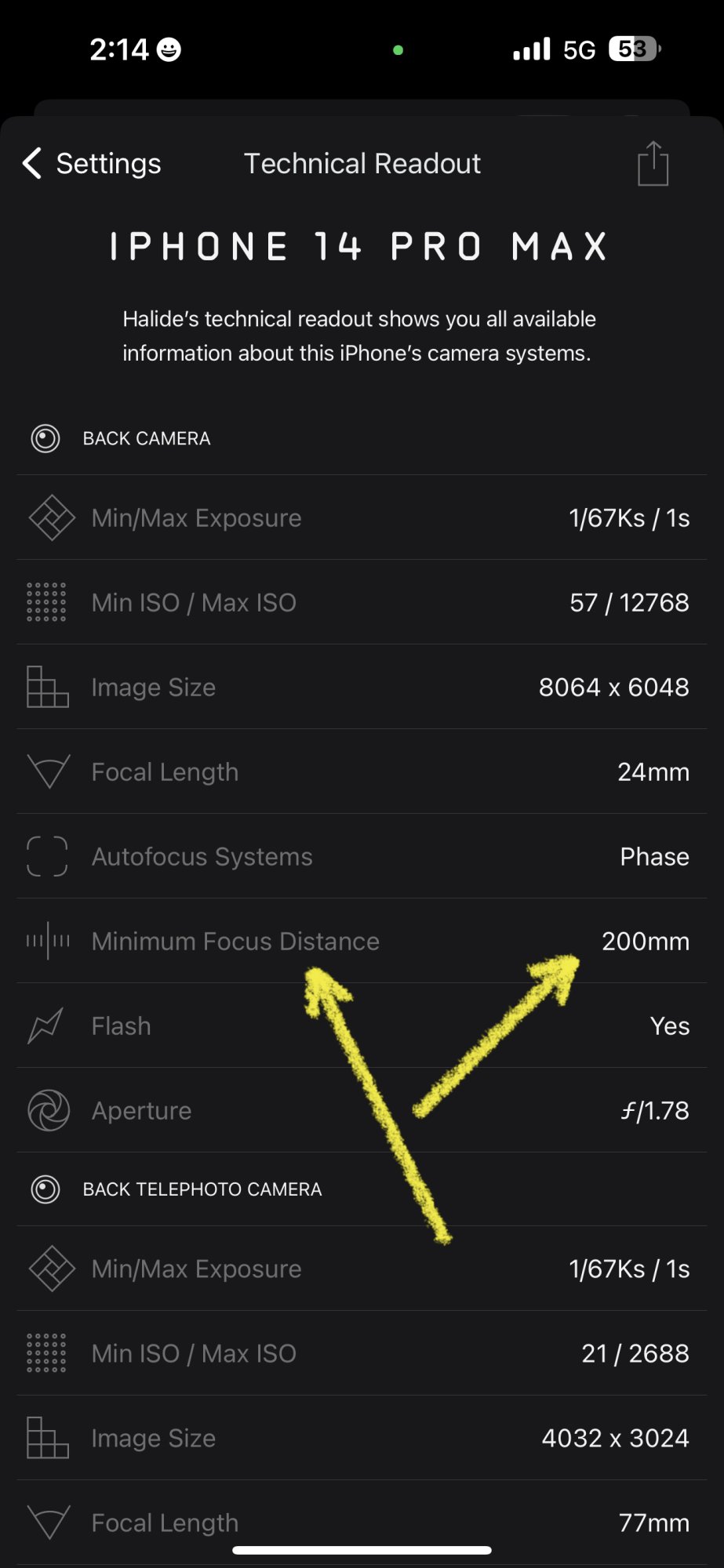

Guys come on. It’s not a problem. The new camera (1x) has a minimum focus distance of 8 inches. Anything closer than that will either be blurry or switch to the macro mode. Once you learn the limitations of the camera you are using and working with, the better photographer you will become. It didn’t take me long to find the specifications on the 1x camera of the iPhone 14 pro max via web search. The iPhone 13 Pro would focus down to 5.9 inches, that’s what you are probably used to. The optical design is different on this new camera. This information has been discussed all over YouTube and the internet, it’s also mentioned in the technical readout of the Halide app. You may find it annoying, but that’s the way it is. The same scenario applies on a DSLR, you buy a new 85mm lens or whatever and the specs tell you how close that new lens will focus on your camera. You just have to read up on it and educate yourself before using the new camera. I have provided the information for you & now that you know, you can go out and photograph things knowing how close you can get. 8 INCHES (200mm) MINIMUM.
Here is an excellent read of the evaluation of the iPhone 14 Pro Series camera by DXO.
https://www.dxomark.com/apple-iphone-14-pro-camera-test-results/

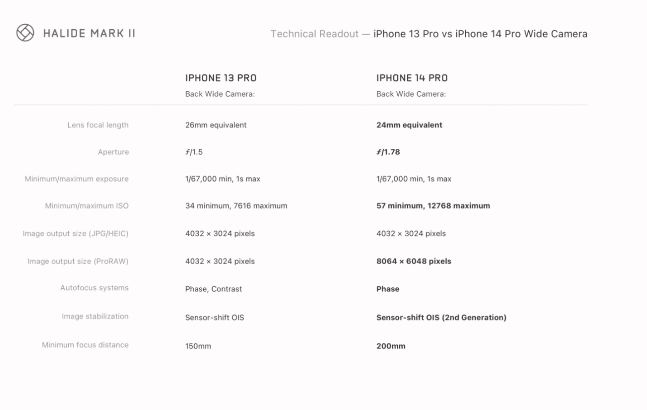

iPhone 13 Pro and 14 Pro camera specs compared:

Right. It’s the apps that are the problem…
