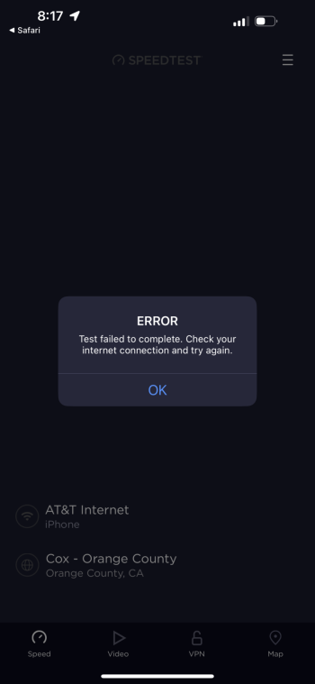

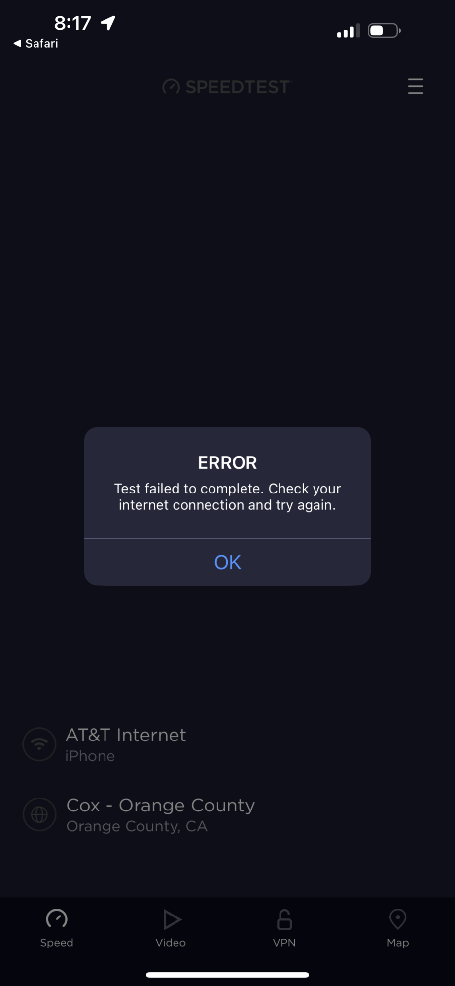

Turned off my cellular data and did a speed test. Says I’m not connected to the internet.
Really would appreciate feedback. Still no Wi-Fi icon in task bar. Wi-Fi shows as connected.
