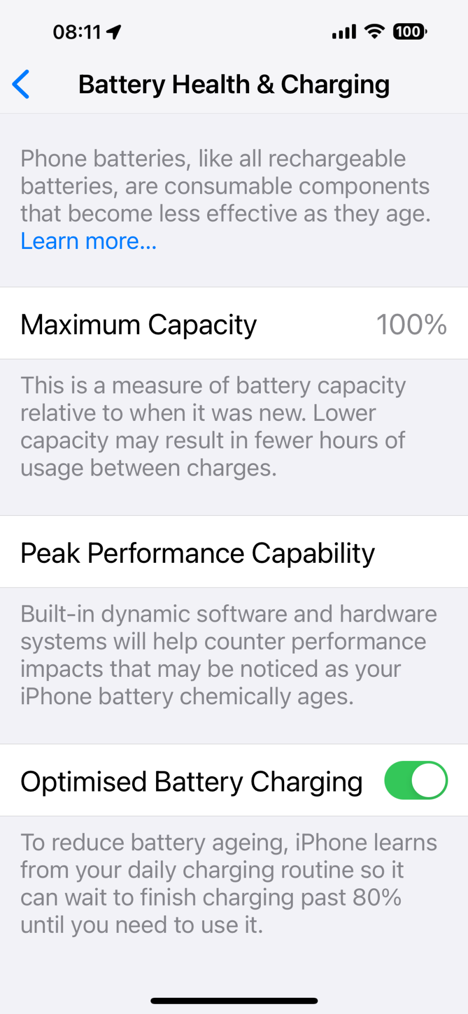

Letting users manually set when the battery needs to be full would be ideal. iOS simply looking at what an alarm is set to would work as well. If I usually need my phone by 8am but I have an alarm set for 6am one day, making sure the phone is ready to go by 6 seems like a a no brainer for most such situations.
I got it to be done around 4-5 am over time by getting phone between 7 to 7:30. But my AW Ultra which I have had since spring does not seem to want to learn from this same thing. Sometimes it will charge at night right away but next day it still is maxed out at 80 percent at 7 AM when I want so I then have to fast charge it so I can have 100 percent for the day I am usually around 70 percent plus after day but if I leave at 80 percent the way it’s optimized charging workers then I will have under 50 percent so I have to do an every other day charging and it never seems to learn. Maybe the optimizing AI has more smarts/instructions or such on iPhone 14 ProMax?

Yep a variable schedule is a pain with the optimized AI thing it just gets confused. It works if you get up around same time all days but it does not figure out after a week or so such a variable schedule it seems set only for 24 hour learning of your schedule assuming most days the same
But setting an alarm should be a pretty good indication of my schedule for that day. This is why I'm not too worried about a robot uprising, they could learn our habits, but if we just make them random, but schedule our attacks on a calendar, they would be caught by total surprise.
