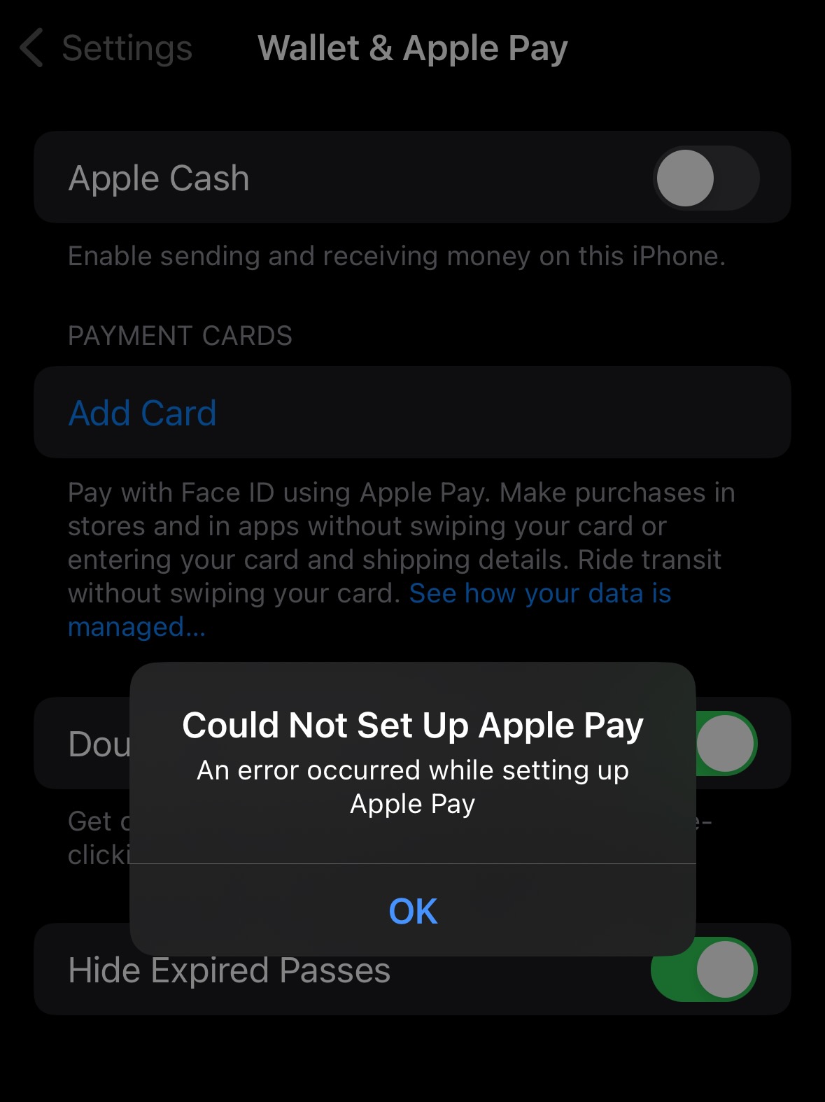

Got a new iPhone 15 Pro 9/22. Restored from iCloud backup. Everything worked fine on day 1. Today, got a popup message saying "Apple Pay Issue". Cannot access anything in my wallet anymore: Apple Cash, Apple Card, Car digital key, credit cards. Won't let me add them back either. Did an iOS 17.0.2 reinstall tethered to MacBook Pro, didn't fix. Did a factory restore, didn't work. Looks like I'll be going to the Genius Bar for a swap. Anyone else seeing this issue?

I did that on initial setup. like I said worked fine yesterday. now just keep getting the error.

not specifically, but I did a complete factory restore and it still doesn't work. any time I try to do anything in Apple Wallet or the Apple Pay settings I get an error.

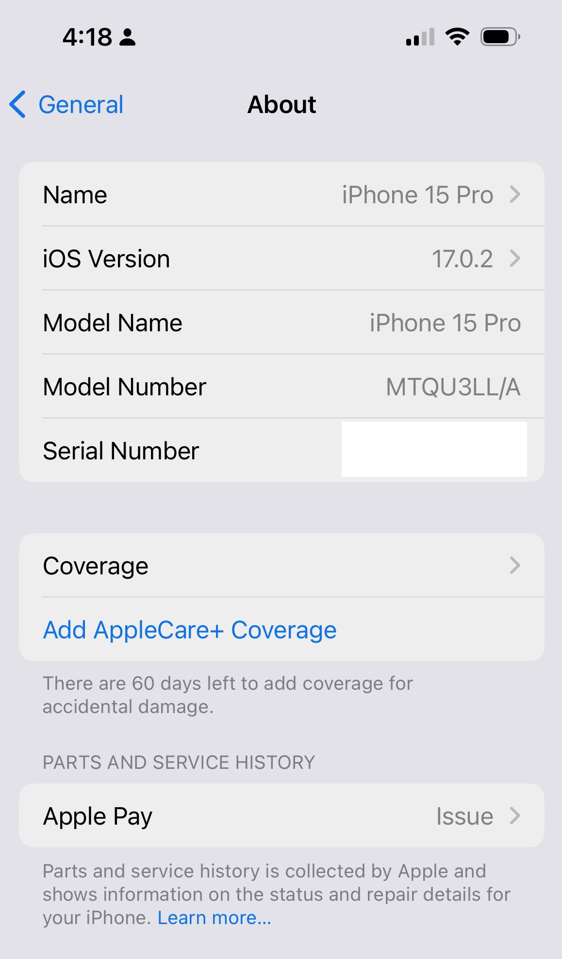

Update—swapped for new phone at Apple Store. They believe NFC module was bad.
Did you experience any issues with the replacement device? I experienced the same issue and now experienced it with the replacement phone. Both times, it occurred after wireless charging in my car.

I don’t have a resolution, but I am experiencing the same issue. Apple Pay is completely unresponsive in my device.
I got an iPhone 15 pro on 9/22 and it happened over that same weekend. Contacted apple support and they determined the Apple Pay unit was completely unresponsive. Just got a replacement unit last night, and on my new device this morning I am beginning to see the same issue. :/
I wish I had seen the car charging comment others have posted here. Definitely feel like that may be relevant for me too as I noticed an Apple Pay issue this morning after commuting to work, and I was wireless charging in my car.

It was hardware for me (chip failed). Apple Store couldn’t repair so they replaced. Went through three phones before the correlation became clear. The fact that it works fine with a 14 pro and a 13 suggests it’s something about the new design of the 15 vs the chargers.

after turning off phone and back on, iPhone automatically goes into recovery mode. I have another service appointment at Apple Store tomorrow and will undoubtedly need another replacement phone. I have a BMW but I drive it to and from work every day with my phone on the charger, and didn't encounter this issue. I also have my digital key in my apple wallet. But both times the Apple Pay issue occurred it was after wireless charging in my BMW X5 on a longer trip than my normal commute. Kudos to this group for identifying the potential link between car charging and the NFC sensor.
