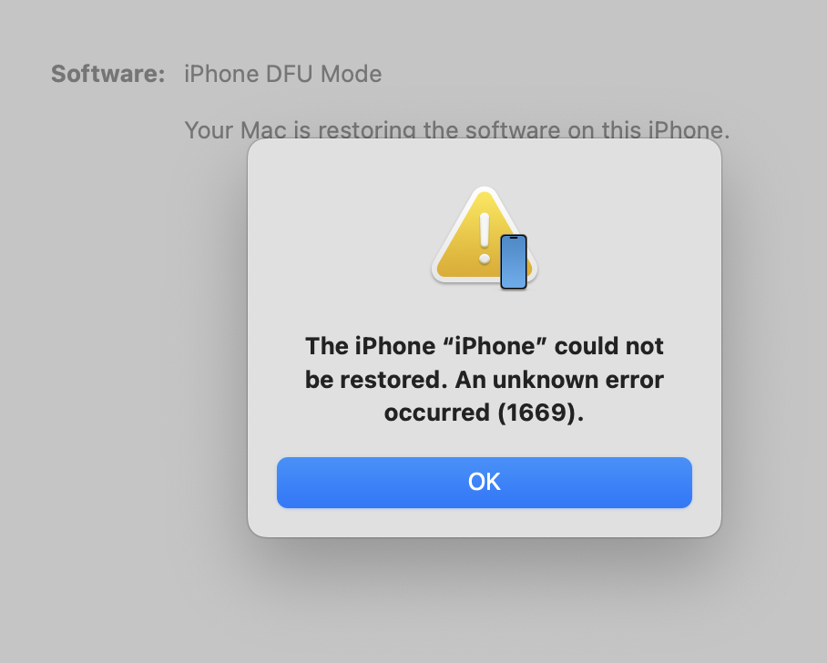

I am testing this iPhone and usually whenever a newer update is available than out of the box, I perform a dfu restore to have the cleanest system possible. With this iPhone I get an error (1669) during the start of recovery phase.
Has it happened to someone else? I would like to point out that I tried with two different m2 Macs, one with Ventura 13.6 and the other with Sonoma rc2, with USB-C USB-C and USB-C USB-A cable without success.

Appreciated, @Banglazed. Failed to include this in my initial post above, but the latest version of Apple Configurator 2 attempts a DFU restore and ultimately returns this error:
Code:
iOS cannot be restored on this iPhone.
Can't restore Port DFU device with NULL prepared boot options
[com.apple.MobileDevice.MobileRestore - 0х0 (0)]
Feedback has been submitted to Apple. No updates as of posting.

UPDATE: Unfortunately, no change here. Anyone else able to test?
