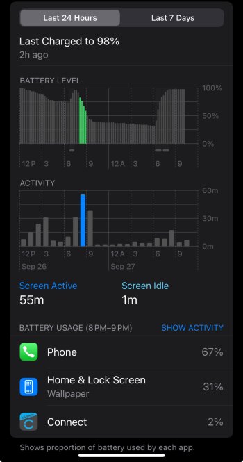

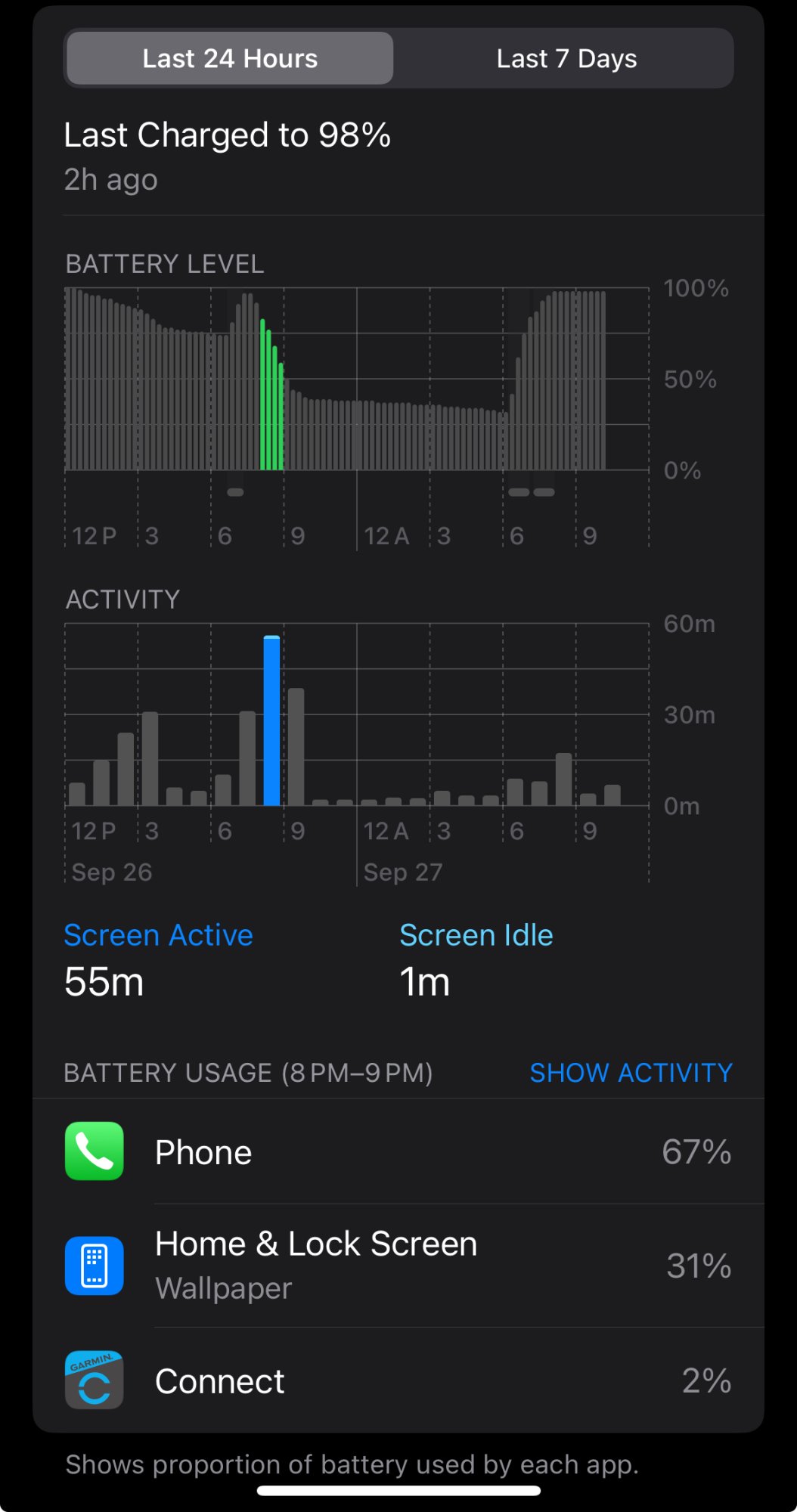

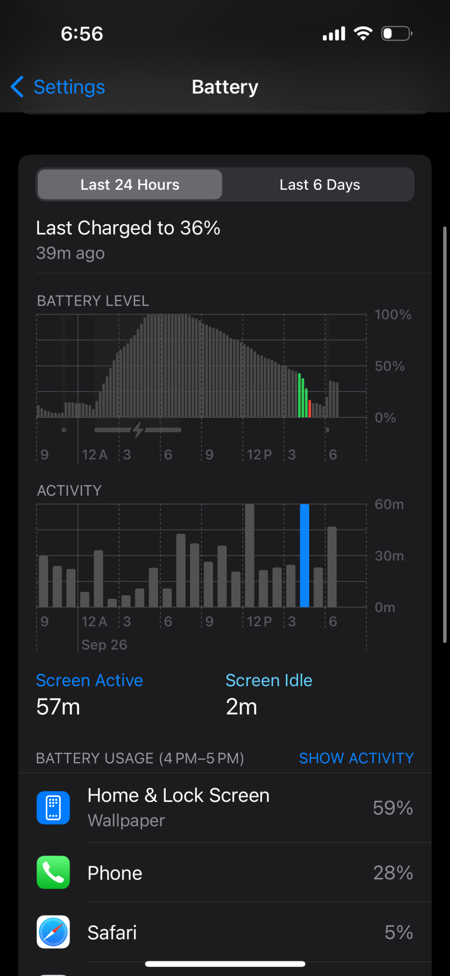

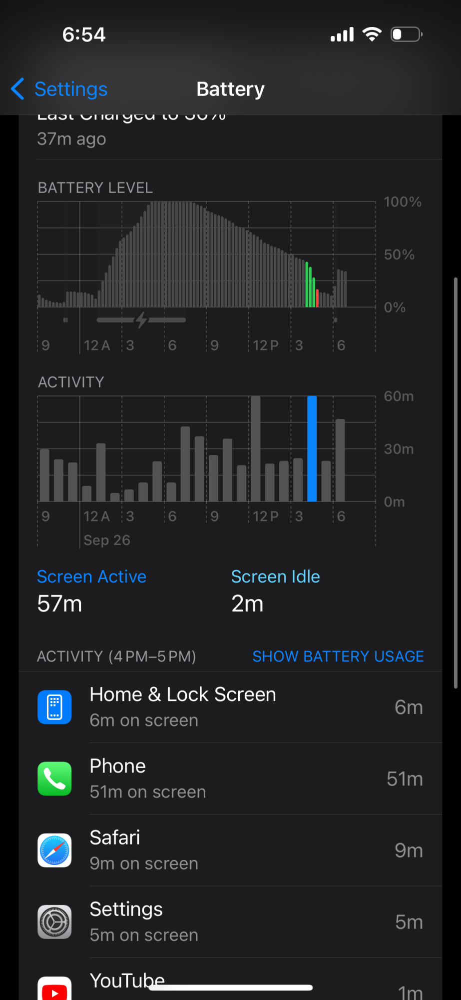

I just had this happen to me during a phone call on my 15 pro. I was actually going to decide between the pro and the pro max by the end of the week, but today during a phone call the phone lost 15-20% on a 20 min phone call. Other than that, all day w some phone calls I don’t recall overhearing, and no overheating as I used the phone normally browsing. So this was worrisome. When I went to see what program took up the most battery, it says “home and Lock Screen” in that timeframe. Now I can’t close this so I’m not sure, maybe a widget going crazy?
Interesting regarding the widgets, I do not have any interactive widgets or any widgets that differ from my iOS 16 setup, but may try removing them to see if phone calls can be made while we wait for Apple to resolve this mess.
I just looked and sure enough, home and Lock Screen soaked up 68% of my battery, I think you are onto something here. Says wallpaper, you know what I bet this is, I bet it is that new IOS17 feature where you can create your phone wallpapers or contact "posters", which are clearly the same code as the wallpapers from iOS 16, running a process and causing the heat and battery drain during a call.

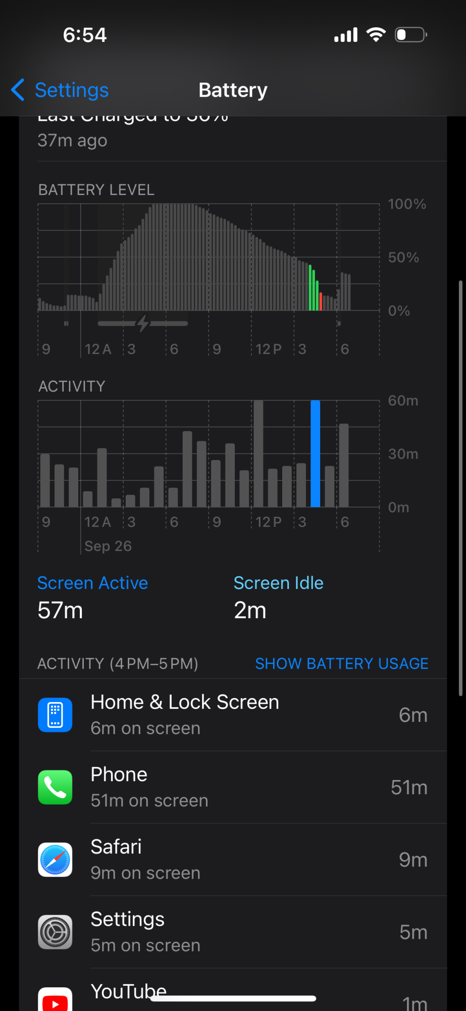

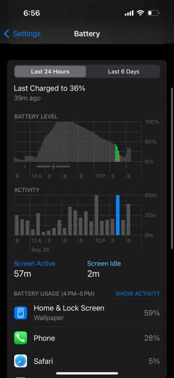

I'm having the same issue with my Pro, shared on the other threads too. But this is an interesting point about the posters... I haven't used iOS since my iPhone 5 (iOS 7 or 8 maybe?) so I haven't done much, but I have added posters to change the background color since I'm not a fan of the grey!
Yep the blank grey space is very boring, I removed the poster, still heats up, I think it’s related though, just buggy code I suppose. Considering an erase set up as new, as o need to be able to make calls
