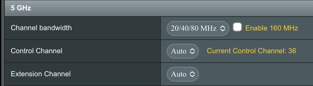

I had terrible speeds on WiFi. I turned off 160 MHz channel width, speeds were back to normal. I then turned 160 MHz back on, speeds dropped. Back to off and speeds were again normal.

The latest IOS 17.1 public beta seems to have solved the problem with the WiFi speed when the 160 MHz channel width is set on the 5G WiFi bands.
I just installed the update, turned on the 160 MHz channel width, rebooted my AIMesh network, and all the speeds are back to where they should be on WiFi.
With iOS 17.1 on my 15 Pro Max, I still have issues with the 160MHz channels. No webpages load and I can't even access my router's interface. I've had to switch back to using 20/40/80. Using an ASUS-AX86S.

No, there is no VPN involved. The problem was due to a setting in my router. The incompatibility was resolved with an update to IOS.
The issue was the channel width on the 5G band. Turning that off solved the problem. Then the IOS update and I was able to turn the option for channel width back to active.
