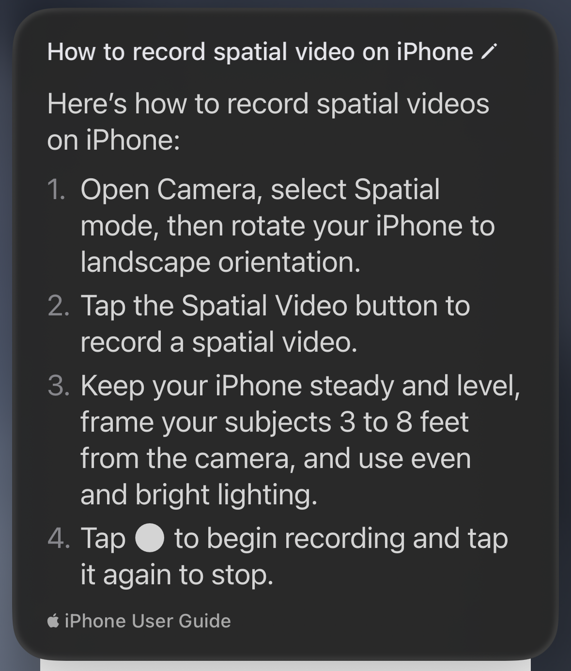

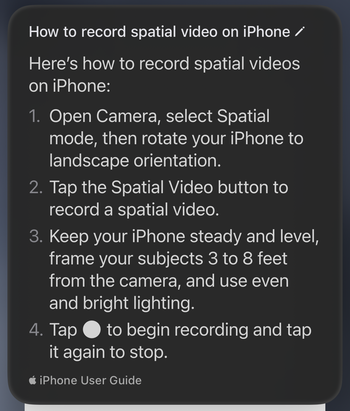

Were you recording spatial video or capturing spatial images (for Apple Vision Pro and VR headset imagery)?
These two capture modes require more light and also you have to stabilise your iPhone significantly when capturing and videotaping.
