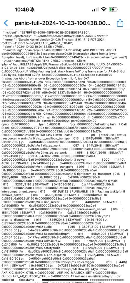

I’ve got the same issue with my iphone 16 pro max. It restarted only when i put it in the pocket or the bag. Here is the panic log. Does anyone know if it’s hardware or software issue.

iOS 18.1 is supposed to fix the restart issue of the iPhone 16 pro series. It´s in the release notes. We’ll see on Monday.
