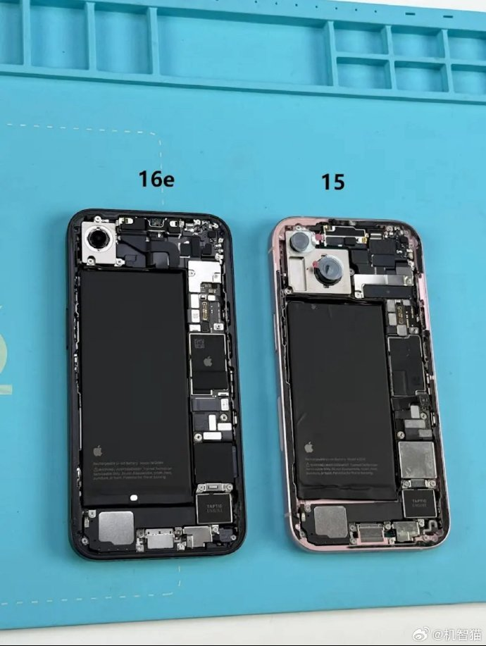

YouTube channel REWA Technology today shared an iPhone 16e teardown video, providing a look inside Apple's new entry-level smartphone.
In its iPhone 16e announcement video, Apple said the device has a new internal design that allowed for a larger battery. The video shows that the iPhone 16e has a 4,005 mAh battery capacity, which is a 12% increase compared to the regular iPhone 16 with a 3,561 mAh battery capacity at the same voltage.
For those who prefer watt-hours as a unit of measurement, the iPhone 16e has a 15.55 Wh battery, while the iPhone 16 has a 13.83 Wh battery.
In addition to being larger, the iPhone 16e battery uses a type of adhesive that can be loosened with low-voltage electrical current from a 9V battery, USB-C charger, or another power source. This change debuted on the iPhone 16 and iPhone 16 Plus last year, and it is rumored to extend to the iPhone 17 Pro models later this year.
The teardown also provides a look at the iPhone 16e's logic board, including the A18 chip and Apple's custom-designed C1 cellular modem. The video said the A18 chip will be harder to repair because it is apparently more difficult to remove.
Finally, the video showed the iPhone 16e's lack of MagSafe magnets for wireless charging.

Hard to judge properly if the 16e modem is more efficient when you put a larger battery than what is in the base 16. The components are smaller and leave more room for more battery, but is there any real power savings from the modem's design?
Reactions: _Mitchan1999
This video seems to point to legit improvements in efficiency. But so far, the few battery tests I've seen don't seem to be pointing to anything more than just a larger battery. It's a pretty signficant size difference vs. the 16 and others in the 6.1" family, so I would think that the size plus better efficiency would have an even bigger difference than what we're seeing so far.

So this enhanced battery is unlikely to come to the 17/17 Pro given space constraints?
Potentially correct. The other two "small" devices in the lineup will almost certainly continue to have smaller batteries, due to additional components within the constrained space of their casings. In contrast, the 16 Pro Max and the 16 Plus both already have larger batteries than the 16e, so those battery comparisons might be a bit more interesting.
That said: the real "proof in the pudding" might be had when we can compare the battery life of whichever other 17-series phones get C-series modems, this fall.
