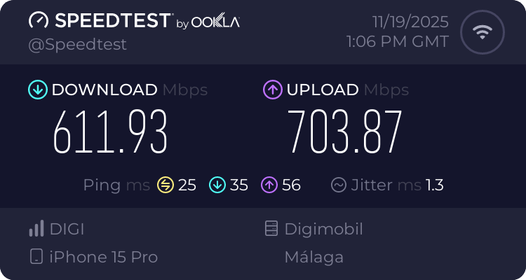

i reach similar internet-over-wifi speeds with my iphone se 2022 , what am i missing?
Nothing at all.
It's a super dumb "study" that seems to be perpetuated by people who don't understand how networks work.
They should simply test the wifi chip performance in a clean environment.
