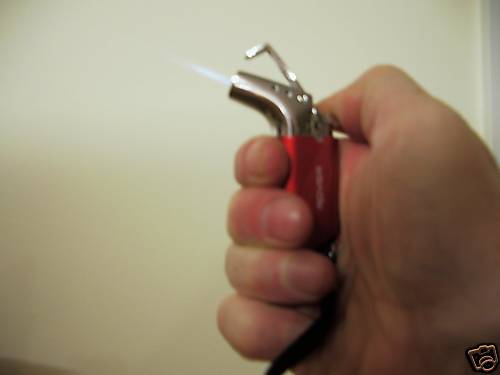

+ it wasnt exactelly a blow torch lol it was a lighter but the flame coming out of it is like a blow torch 's flame its pretty much like this one
