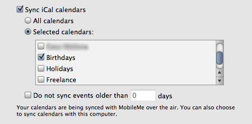

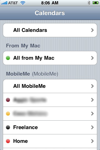

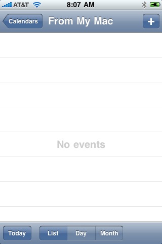

I'm assuming this is new in 3.0 because I've never noticed it before, but I guess it could be older. You can now (allegedly) sync your calendars over the air with MobileMe and choose to sync them via iTunes. I tried to get it to work with my Birthdays calendar, but the actual info isn't moving across. Here are screen shots of iTunes and my iPhone calendar area. Any ideas on what to do?

I did a little more testing and it turns out this behavior is confined to the Birthdays calender. Any other iCal calendar (including subscribed ones) sync as expected.

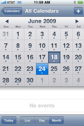

One thing I noticed after subscribing to the Birthdays calendar is that now there is a dot under every day (in Month view), even when there is no event on that day.

oh, you're right. same here. I rarely use month view on my iphone, but -- still... 😕

How are you navigating to the Calendars page on your iPhone (your second screenshot that shows your Mac and MobileMe calendars)? Under calendar settings (Settings-->Mail, Contacts, Calendars) the only choices are New Invitation Alerts, Sync, Time Zone Support, and Default Calendar. I don't see any screen that lists my MobileMe calendars. Thanks.

It's in the actual Calendar app. Touch the "Calendars" navigation button in the upper left part of the screen and it will take you to that page, where you can select which calendars you want to view.

OK - I didn't realize that it was the same page that lets you choose which calendars to display, probably because your screen shot had From my Mac and MobileMe sections. (I've never turned on syncing in iTunes, so my page only shows one calendar list.)

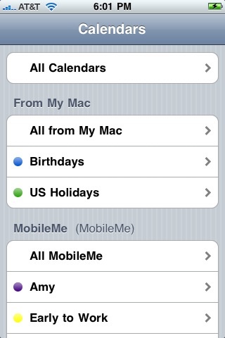

My birthday subscribed calendar is working on mine now. I use MobileMe and sync calendars OTA. Then last time I synced with itunes, I clicked the box to sync only Birthday calendars. Voila! Here's a screen shot of what it looks like. As you can see, it's titled "All from My Mac". But since I only synced the Bday cal from my mac, that's the only calendar there. Working perfectly 😀
ETA: I just switched to a subscribed US Holidays cal and it's working now too, screen shot attached below 😀

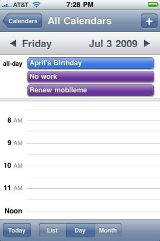

Do birthdays actually show up in the calendar on your iPhone? By adding two calendars (the same two you did), I was able to get both calendar titles to show up on that screen, but none of the Birthday calendar events ever showed up on my iPhone's calendar until I did the publish/subscribe method.
Yeah, here's a specific example.... showing my regular, Mobile Me cal (the purple) with the Birthday cal on the same day 🙂

Everything syncs now as it should, eventless days no longer show the dot in Month view and I don't have to worry about my two MobileMe-synced Macs fighting over which gets to publish the Birthdays calendar
