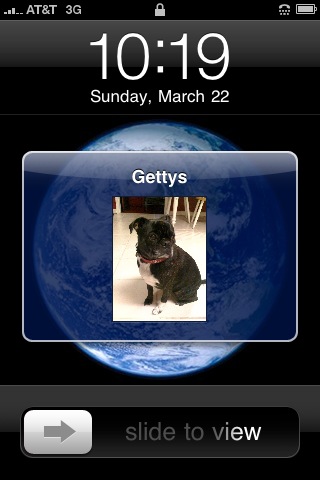

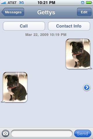

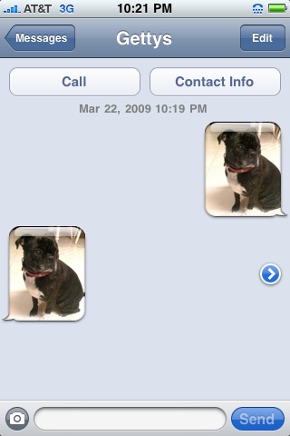

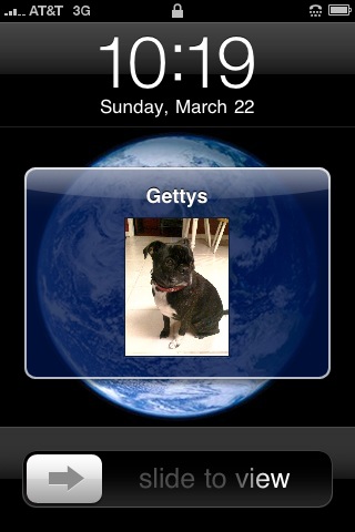

Just wanted to let everyone know I have MMS working now. I download the file from the 3rd page on this forum. I updated the carrier settings. I called att and told them that I am a developer and needed to get mms provisioned on my account. I called 2 times. The first lady had no clue so I just got off the phone and called again. The second person didn't know what i was talking about either but i asked her nicely if she could transfer me to level 2 support. She did, the lady on the phone was very helpful. I explained that I had the correct carrier settings on my phone but that I just needed att to let me get mms. She explained to me that they have to take off the block on each phone (not the entire plan, so she had to do both phone numbers) The block lets there system know that your phone is capable of getting mms. She said that they have to take off the part that send the link to the web site to view your pics and change it to wap/push. She even tried sending me test mms and was excited that she was going to get it to work. After about 10 min it did not work and I told her thank you for changing what need to be changed and got off the phone. I just about gave up at this point but after about an hour I just tried it again and it worked!!!
