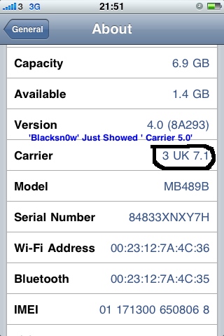

Then after doing all the above. I was ready to settle down install my apps,music etc. I Put my 'Three' Sim card in, another carrier update popped up? Downloaded & installed it. Noticed something different after this, Before when using blacksn0w it just showed 'Carrier 5.0' In The Settings>General>About. Now it showed ' 3 UK 7.2 ' Which mean's i have no problems setting up the internet APN settings, tethering, or get that annoying pop-up while trying to make a call.

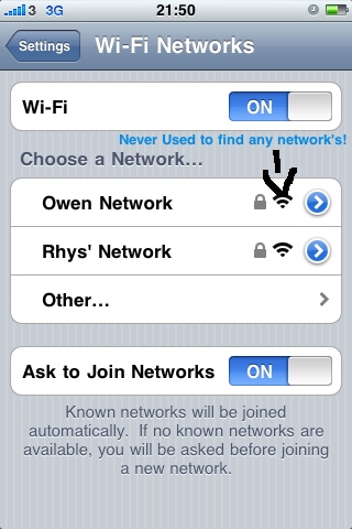

Ok so later that night, few hours after the carrier update. I had tried to connect to WiFi for SSH Purposes, No Luck, Turned the phone off, and back on again, straight away found all 3 Of my home networks. i just thought i was lucky and didn't really think anything of it, then went to bed as it was late.

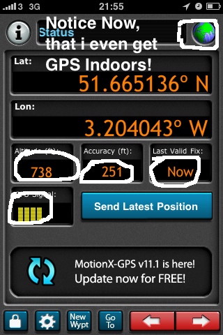

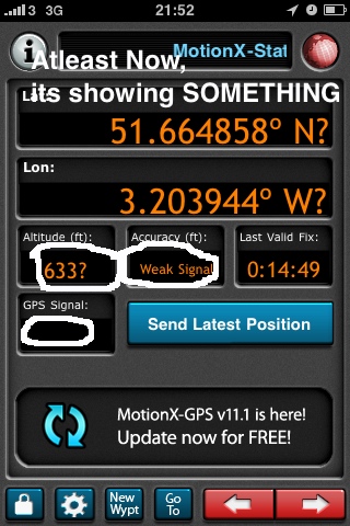

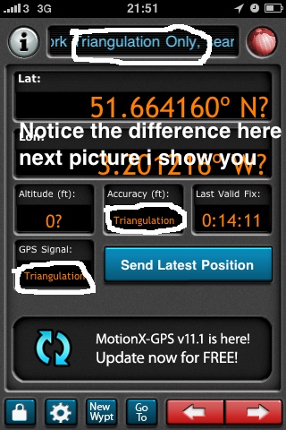

Now Today, as i came home tonight from being out, i had sat outside in the Summer sun! and thought why not try and connect to WiFi, There you go straight away found all the networks in my house and others around me. So i thought i wonder if the GPS has also been fixed, i started up the ' MotionX GPS' Application, and i had my doubt's when i saw 'Triangulation Only' because thats what it usually said when it didn't work. But i gave it a few seconds and i started to see results!
But then weirdly, my phone froze, so i done a soft reset ( held power & Home button) Phone came back on and i had nothing no WiFi Or GPS.. i was really disappointed, 10 Minutes later i thought, why not try again, and again it works! and ever since that, has been working right up until now * Touch Wood* Still works as i type this.
So in Conclusion, i think that the new Baseband, And the New Operating System, and the ultrasn0w has fixed the problem, though i can't 100% Prove it also could be pure luck..
