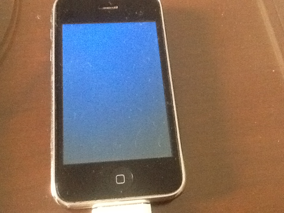

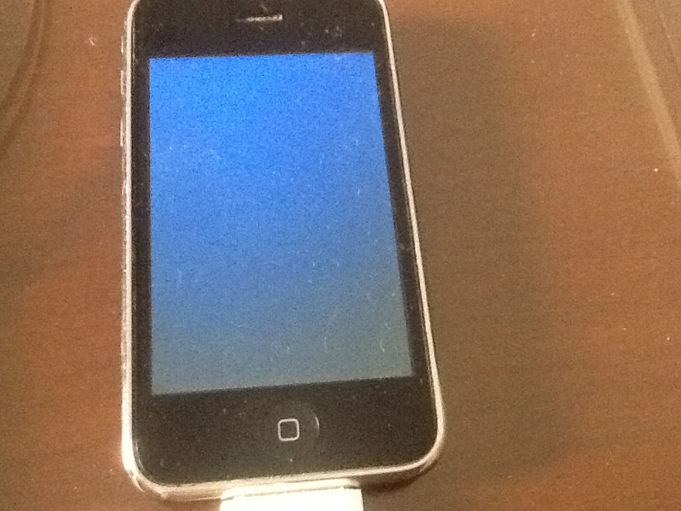

I just discovered that when i start jailbreaking i hear the device disconnect when redsn0w says "The rest of the process takes place on your device"
That's weird.
Wonder if the phone has a hardware issue.

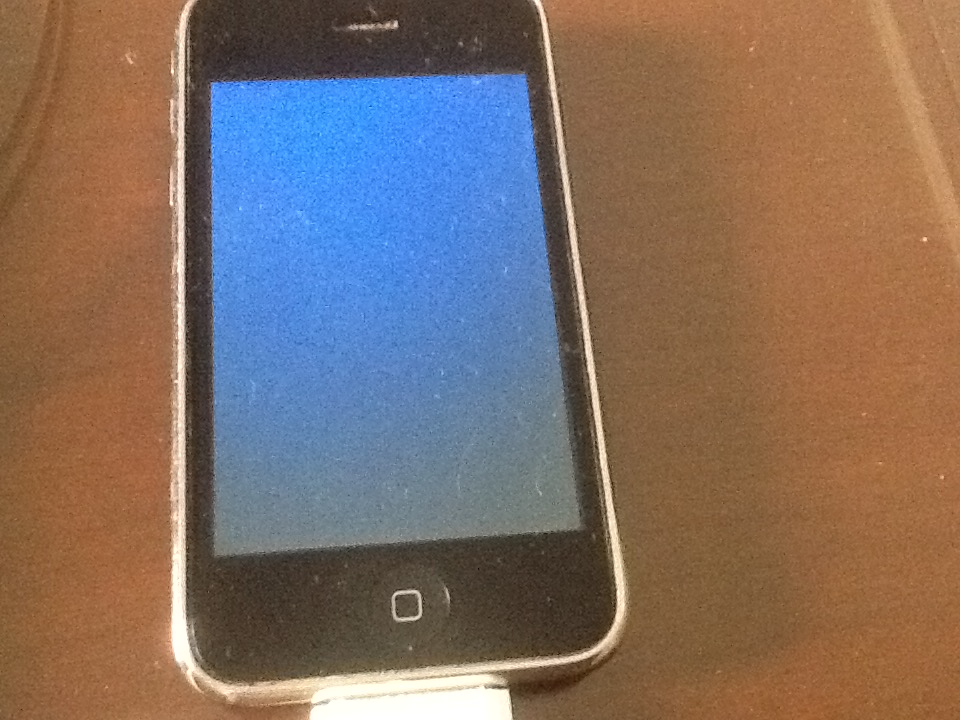

It shouldn't show you a blank screen.
It should look like this below:
Everything works great nothing is broken, whenever im restoring a dfu ipsw it looks like the photo you sent above, do i downgrade to iPhone OS 2.2.1 then upgrade the base band downgrade it and then upgrade it to iOS 4.2.1?
No, you have to fix the baseband.
That's where the problem is.
When you restored to stock ios the baseband gets messed up because the ipad bb was installed previously.
So you have to somehow flash the ipad baseband on it again and then downgrade the baseband.
Then once the baseband is downgraded to a an iphone version baseband then you can restore with itunes with no problems.
