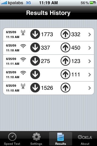

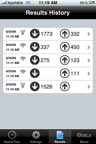

    Test results -- FAIL
    I fully concur. My 1G phone without the 3.0 update is running fine alone with my laptop. The 3GS drops the signal, has low strength/speed, or fails to reconnect. Speed test is as follows. Notice the wifi test, then I did a network reset as recommended by some threads, then retested. Same thing. 3G network is fast--WIFI not.
    This is a big pain in the rear when you have to turn off WIFI because it is locking things up because it isn't switching, or running like a Hayes Smartmodem. Apple are you paying attention?
