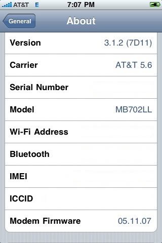

I've been having this issue since I upgraded from 2.2.1 long ago when I got my iPhone. The problem: when I turn on 3G in an area without 3G coverage, my iPhone will sit on "Searching.." and sometimes go to "No Service." If I turn 3G off, it stays on "No Service" for a while before establishing a connection. Additionally, when I move around a non-3G area and my iPhone loses signal, it will repeat the same long "Searching" thing.
Should this be happening? I'd like 3G to remain on because areas I travel to have 3G service, and I'd like it to switch when I do get to those areas without having to manually turn it off and on.
iPhone 3G info:

I've tried restoring through the normal iTunes method and through DFU. Nothing seems to fix it. It works fine in a 3G area, but in a normal EDGE area, it has problems.
Like I said, it seems once I upgraded past 2.2.1, this occurs. It didn't happen before. I've been told once that it's possible that the modem firmware is corrupted because of some beta issue before and it's basically unfixable.

You could downgrade quite easily to 2.2.1, if you really think that makes a difference, but I've not heard of software problems causing the issue you're having. IMO, it sounds like a hardware issue.
The freezer test has been used to detect hardware issues with wifi. I haven't heard of anyone using the test for 3G/EDGE purposes, but maybe it could be used. It consists of putting the iPhone in ziplock bags (I suggest two to prevent condensation) and putting it in the freezer for about 20-30 minutes.
