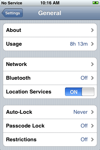

Settings
- General
---Location Services ON/OFF
