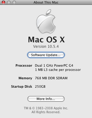

Mac MDD Dual G4 10.5.4

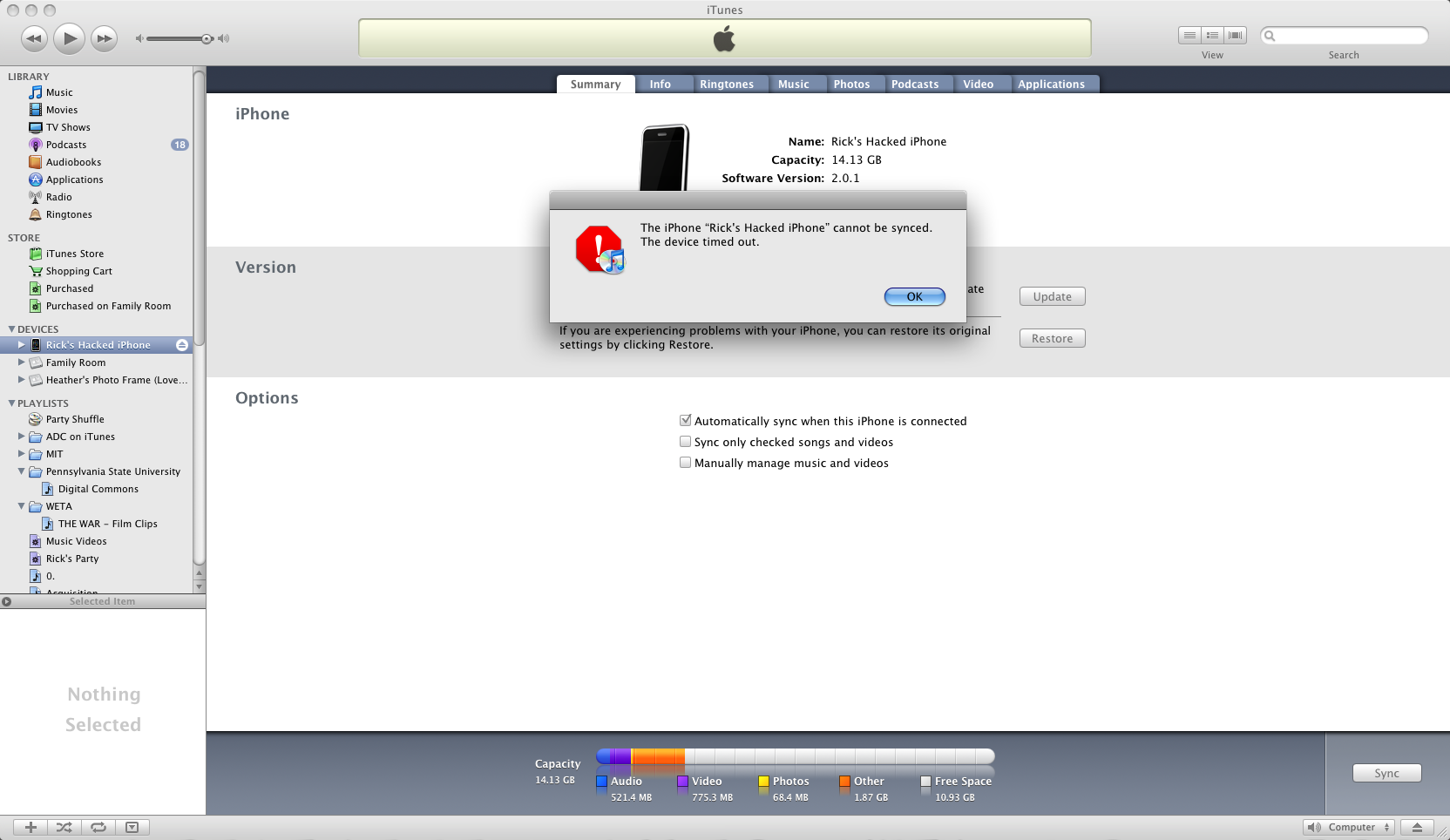

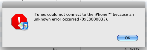

One time I get "unknown error 0xe8000035 cant conect" then after it conects and syncs I get "the device timed out"
