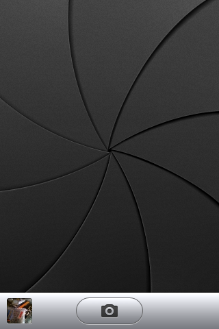

so i dropped my iphone today with a silicon case on it
and it just so happen to drop it either just before i click the shutter button or as i clicked it.
a couple hours later i tried to take a picture with it and as i click the shutter buton it makes the shutter noise and it does that litte screen it shows before the picture is taken and gets stuck on that screen.
is my camera toast or is there something i can dooo.
pic related Screen it gets stuck on
