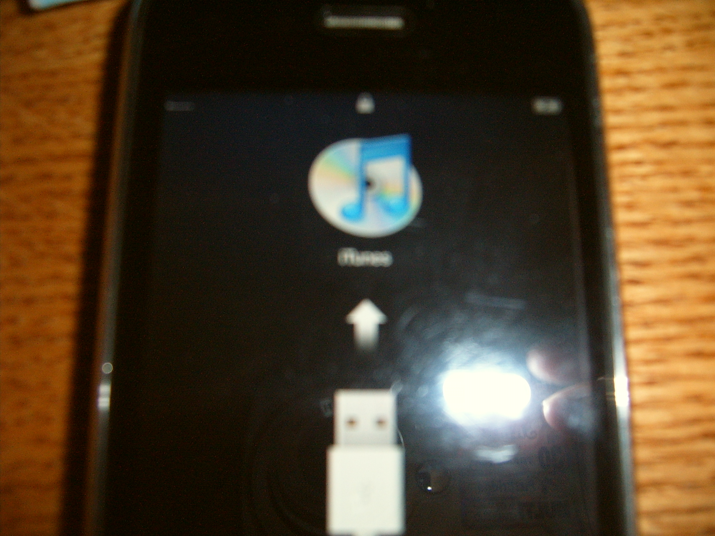

When I power the iphone, all I have is the itunes logo and the NO SIM card inserted message.

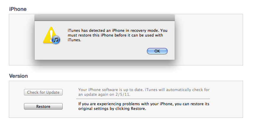

I feel like you left out some details. Its sounds like your iPhone is stuck in Recovery Mode, Are you on Windows or Mac?

his phone is stuck in recovery mode because the update process failed because he was jailbroken Put the phone in dfu mode connect to itunes then follow th on screen intsrtuctions there phone is fixed

I am on AT&T. Unfortunately, I don't know what version I am on. Again, when I turn on the phone, all it shows is the itunes logo and the usb. Therefore, how can I check to see what version I am on?

Based on the information you have given, you are not using the newest software. The image you attached above has the old iTunes logo when in "Connect to iTunes" mode, the newest OS (4.2.1) uses the new iTunes logo.
So, to ensure that you are on the latest software (and yes, you will loose you jailbrake), Your only option now is to click on the Restore icon and let iTunes download the latest software, then let it automatically update.

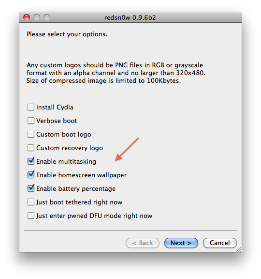

Side effect of having a 3G on iOS 4.0+. Disabling multitasking and wallpapers when jailbreaking with redsn0w will help.
Hmmm....I didn't see "disabling multitasking and wallpaper" in redsn0w.

To Disable Multitasking, Wallpaper in the iPhone, just don't enable it (don't check the box) during the Jailbraking process.
Thanks for the screen shot. When I used redsn0w, there were 2 checkmarks that were already defaulted to "install Cydia" and "enable battery percentage", therefore, I did NOT check anything.
