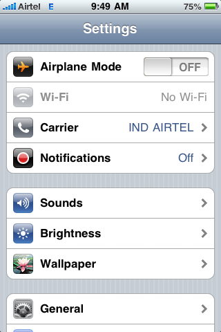

i have an unlocked and jailbroken iphone 3g. it runs on the 3.0.1 version firmware. a month back i got this wifi problem. on the first day, i could search for wifi connections but my phone could not detect any. the next day, the wifi option seems to be disabled. the wifi option is alone dim and it says 'no wifi'. i have attached a screenshot of it. please help.

check your warranty and if you have a warranty left on it restore the phone and take it to apple they will give you a new phone. other than that i dont know if there is a fix for it.
To determine that it is a hardware problem do the freezer trick: Put the iPhone in a ziplock bad and then put that in a ziplock back (to prevent condensation, also remove as much air as you can) and put in the freezer for 10 minutes or so. If you have wifi for a bit after that, then it is definitely hardware. If not, it could still be hardware, but do a restore in DFU mode and see if it changes (you'll need to restore anyway to take it to Apple).

I had an unlocked iPhone 3G. While charging the iPhone, it started getting hot.
WiFi deteriorated progressively after that over the next couple of weeks - dropped connections, then unable to detect WiFi routers.
I took it to the Apple store (after restoring the iPhone to a standard state - no longer unlocked.
I used a friend's AT&T SIM, but removed the SIM when bringing it to the Apple store.
The service rep looked at the phone and noted I was six weeks past my warranty, But he said he would speak with his supervisor and then replaced the iPhone for free!
