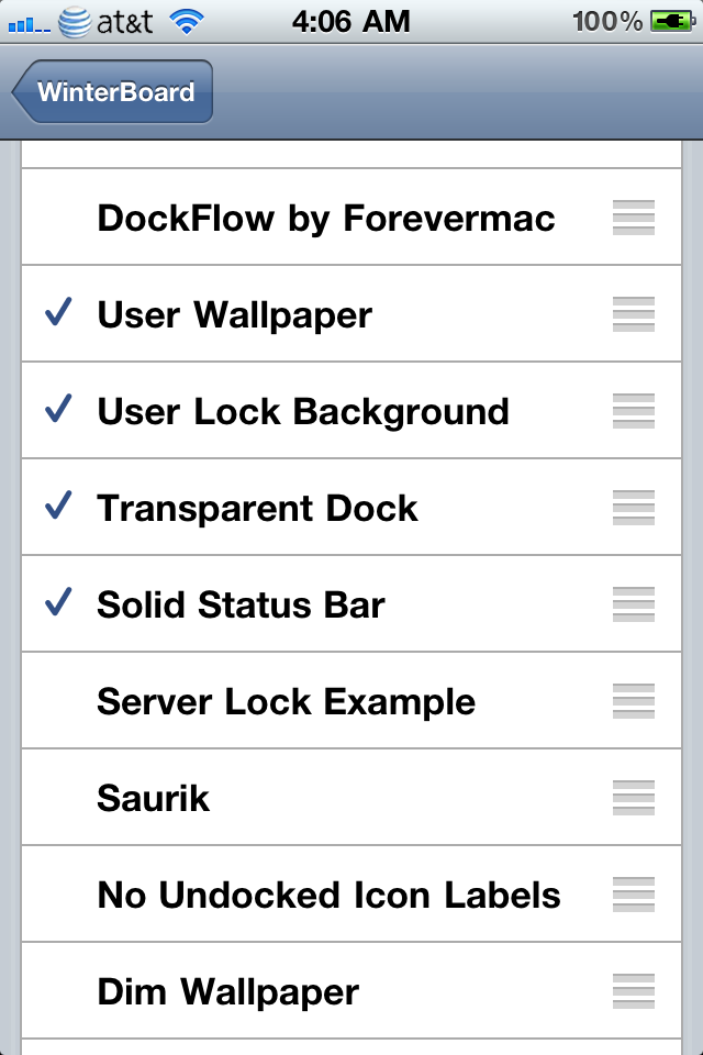

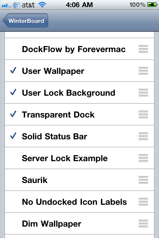

On an iPhone 3G I installed Winterboard. I have a few themes, but none are in use right now.
I have an image on my phone that I want to use for the lockscreen and the background wallpaper. I selected the wallpaper in the Settings. I set User Wallpaper and User Lock Background to be selected. The wallpaper shows for the lockscreen, but not for the springboard.
I also noticed that the above settings do not override any wallpaper/lockscreen images that might be applied using a theme.
Am I missing something?
How do I set a lockscreen image separate from the wallpaper image (without using a theme)?
Other Winterboard options do not seem to work, either. For example I have No Docked Icon Labels selected, but the dock still shows them.
Are you on firmware 4.x? There is a known issue with Winterboard right now that doesn't allow for custom wallpaper with certain themes.
Also, in Winterboard do you have an option for "User Wallpaper"? You might see if that is checked. If needed, drag it above (on top of) your theme. I could be an idiot about this but I believe that the highest ranked option in Winterboard overrides lower ones.

3G iPhones don't have home screen wallpapers enabled by default.
You can edit a .plist somewhere to enable...if you would search, you would find a solution.

This:
I had the same problem, I could not get winterboard to let me set my own user wallpaper on the homescreen. Here is the site that I used and it worked perfectly.
http://jaxov.com/2010/06/enable-home-screen-wallpaper-ios-4-iphone-3g-without-redsn0w/
only thing is it tells you that you need to add a source to get iFile to work. I dont believe you have to because it gave me an error when i added it and I was still able to download iFile. Then Cydia kept giving me an error so I went in and deleted the source using iFile and my background and iFile still work fine.
When I upgraded to 4.0.1 I used jailbreakme.com and had the same problem.
I edited the file “/System/Library/CoreServices/SpringBoard.app/N82AP.plist”
and added the following text using iFile:
<key>homescreen-wallpaper</key>
<true/>
<key>gas-gauge-battery</key>
<true/>
