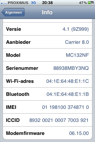

I have an iPhone 3Gs here and I've been told is has been unlocked a year ago. I do not know what type of unlock it was.
My phone is on 4.1 now but I really want 5.1.1 to get more app-compatibility.
My question is, can I update using iTunes, without having the risk of ending up with a simlocked phone?

Looking at your baseband, it is on the iPad 06.15.00 baseband, which means that you are on a software unlock using ultrasn0w, and not an IMEI Factory unlock.
However this is all useless point, if I am not wrong, since you never updated to 5.1.1 (hence no SHSH Blobs), and Apple stopped signing the firmware, you have no way to update to 5.1.1. You would have to go straight to 6.0.1 I believe. And I dont think ultrasn0w works on ios6.
No, you cannot just update.
You have the ipad baseband installed 06.15.00 and if you attempt to update or restore to stock firmware your iphone will be stuck on a boot loop. It wont even be able to load and will always error out.
You need to jump through many many hoops to update your firmware, keep your iphone JB and maintain your unlock.
Not for the faint of heart or if you dont know what you're doing with JB iphones.

Then downgrade your baseband with redsnow and then you can update your firmware with iTunes.
Don't try to update it if it still has the iPad bb installed.
