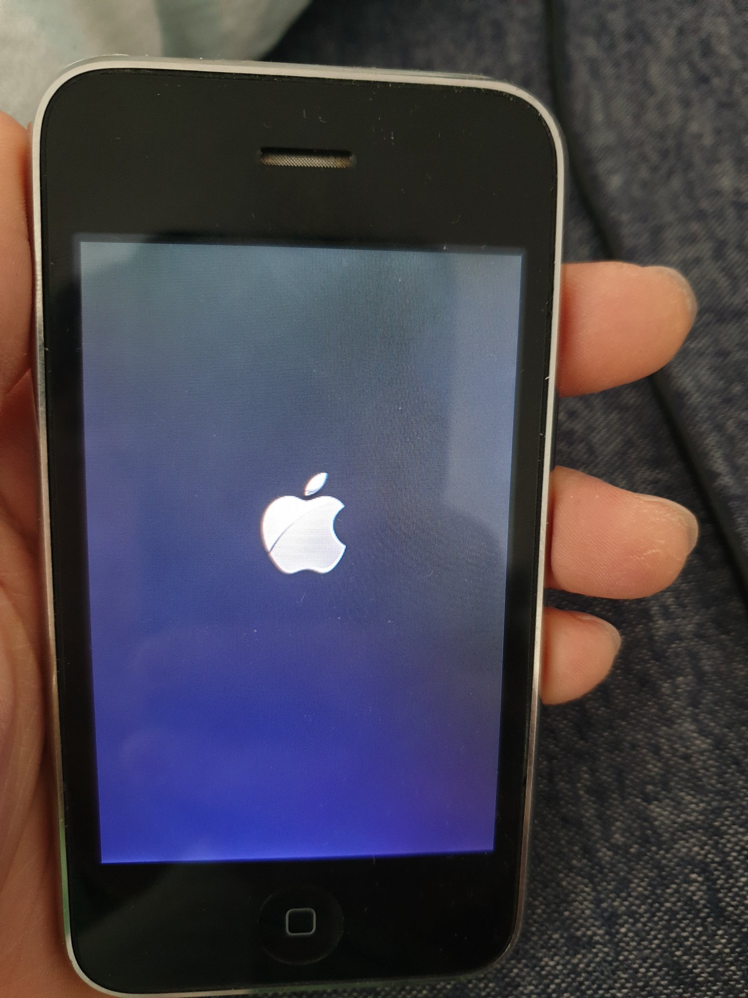

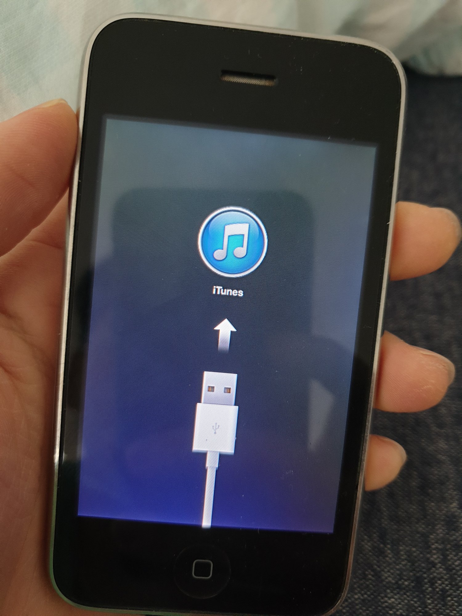

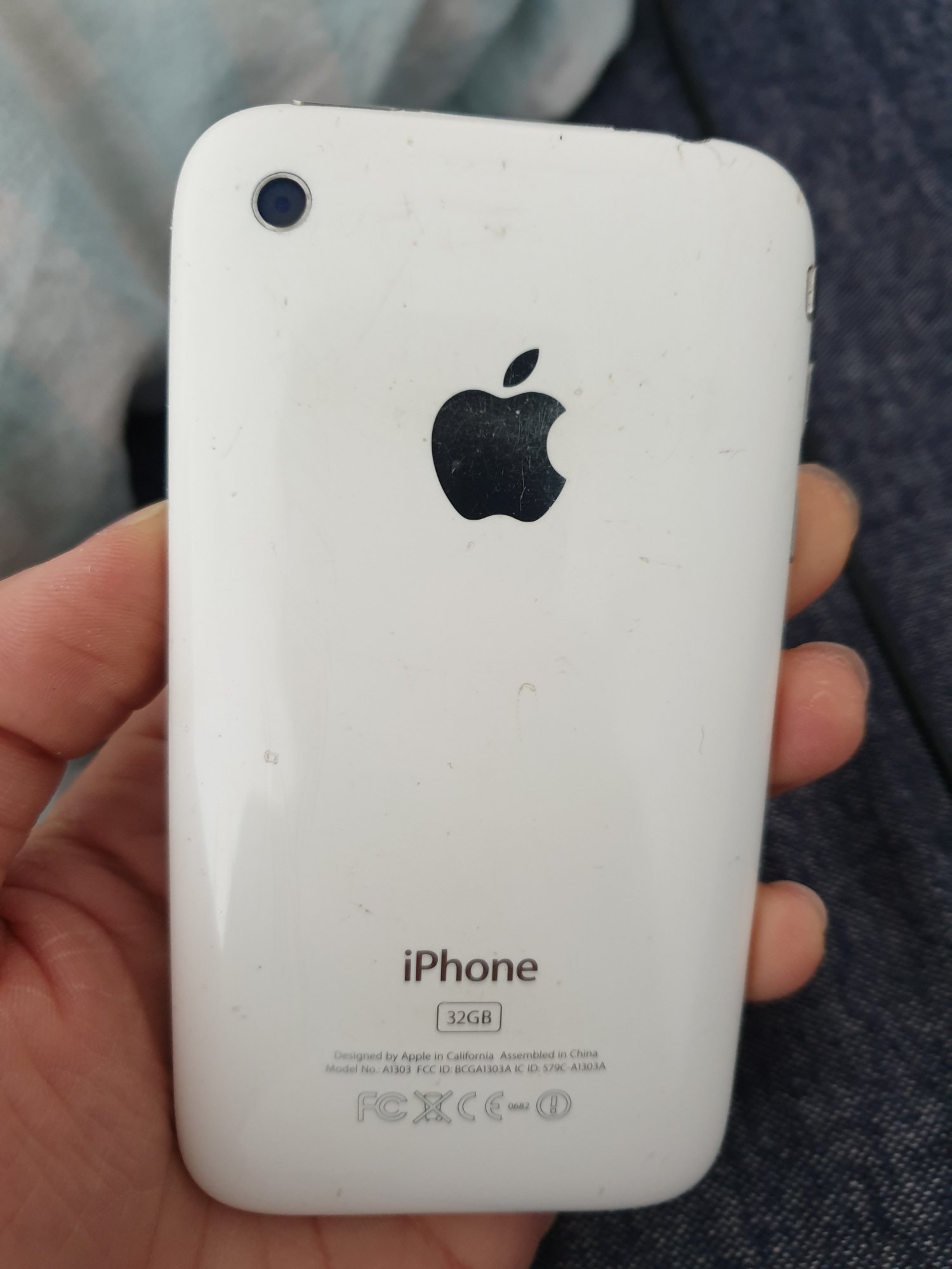

HEY there 😉
I am Marco from germany , i have an old iphone 3GS with 32GB storage. I've tried to fix it with itunes.First it seems to be allright but after 75% a pop up appears and say "error 1" in itunes ... So our Problem is very similar.But i still dont know how to restore the Iphone Can u Help ?
Sincerely Marco
