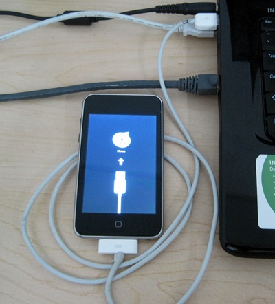

For starters, my friend gave me his 3GS iPhone (new Bootrom), Serial number is 88952LBK3NQ (week 52 of 2009) hoping that I could fix it as it was showing the iTunes USB Cable Logo:
And as I considered myself quite familiar with the process of restoring firmware, I went ahead and restored it to Stock 6.0.1 through iTunes, I have no idea whether the Baseband or the WiFi were working before this, and my friend either..
