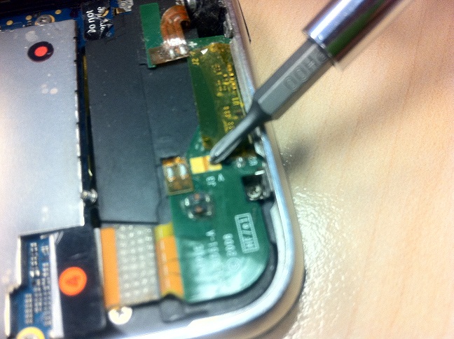

I would recommend trying a new dock connector before pulling the glass off. Use a screwdriver and "jump" from the gold contacts on the dock to the silver bezel around the phone. If that doesn't simulate a home button press, it's the dock. That particular issue would have nothing to do with the ribbon cable on the button itself.
How do you get a screwdriver to touch both at the same time? the silver metal is on the outside of the case.. i think i might not fully understand what you're saying but i want to try it.
I've attached a picture. It doesn't have to touch both contacts either. Just make a quick connection like in the picture. If it doesn't work, the dock is most likely bad.

oh ok i see. but why wouldn't jumping the two gold contacts together not be the same thing?

Well the voice control comes up when you hold the home button for a few seconds. I'd say there's some kind of short and the dock needs to be replaced.

Yes, I'm 100% sure and yes, that's the part you neeed. If you can't simulate a home button press then the dock has a problem. Unless you have water damage or something else major with the phone, you'll be good to go with that dock assembly.
Well I have good news, it worked! Thank you again so much. Out of all the researching I did nowhere did I find replacing the dock connector as a solution, I'm so glad I signed up and you posted 🙂
