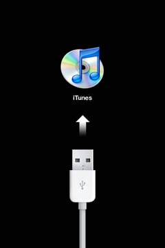

I did a similar thing today and feel awfully stupid about it
I had a jailbroken, unlocked 3G with SOME OS that was 3.0 and above. It had no sim in it for awhile and I figured i'd give it to my dad so I went in thinking the reset all settings would be "efficient" to give him a fresh phone.
Anyways, after all said and done, I got the spinning wheel of death. I then turned off the phone by holding down the power and home button together.
I later got into my Mac and opened up iTunes. Plugged in the iPhone and nothing was responsive obviously, so I went into "DFU" mode. It did so and asked to install 4.01 via restore. I did so and after it was downloaded, the phone attempted to install the software. The bar on the iPhone went to about 2/3rds and just HUNG there.
At this point I stopped the process (holding home/power once more to turn off the phone), dc-ed from Itunes and restarted my computer. NOW i am trying to retry the whole restore process, and everytime I do i get the error on itunes saying there was an "unknown error" code 1604 🙁
Anyone know what the next step I could take here? Did i screw the 3g up very badly (bricked)? Should I try to use another computer? (Windows 7 with latest itunes installed)
The iPhone, when turned on, looks like this on the screen now:
Thanks for any help, this has been taking the better part of my Sunday.
