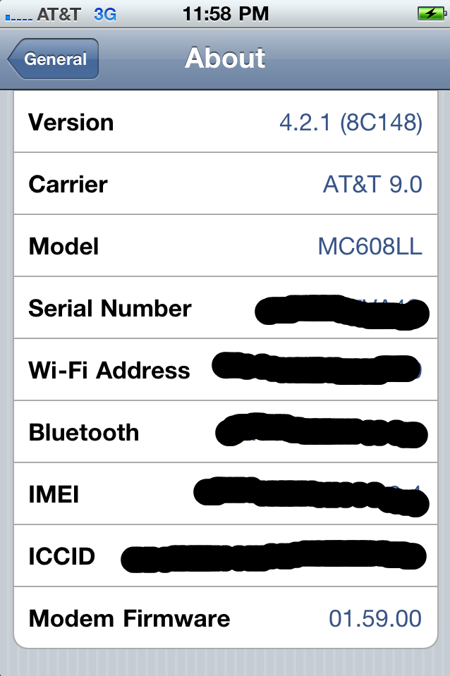

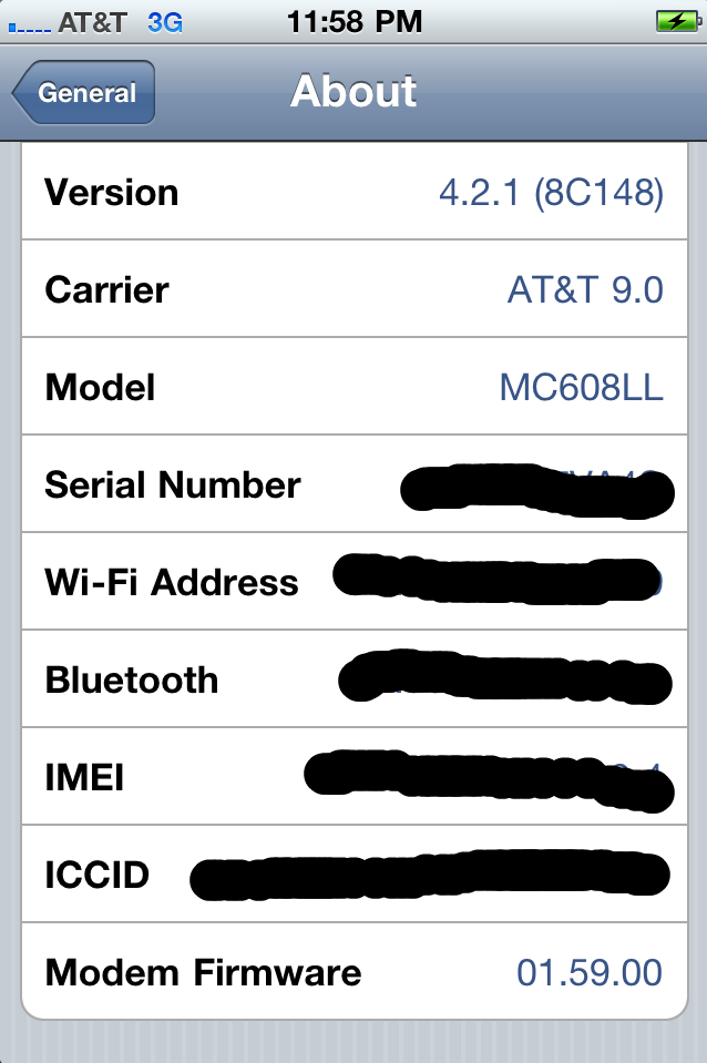

In the screen shot below is my iPhone 4 which I just upgraded.
  • 4.2.1:1.59.00.png
