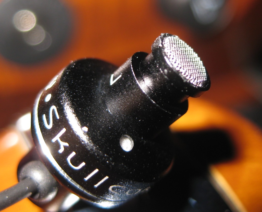

I have the older FMJ's with the metal and they work perfect with my iPhone 4....
Can you tell me if your FMJ's look like this or is the metal mesh cover flush with the metal body?
