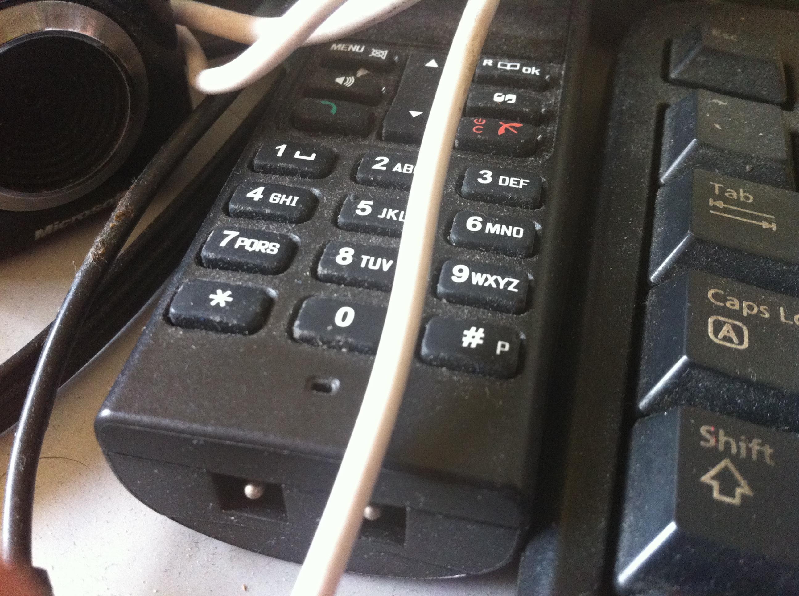

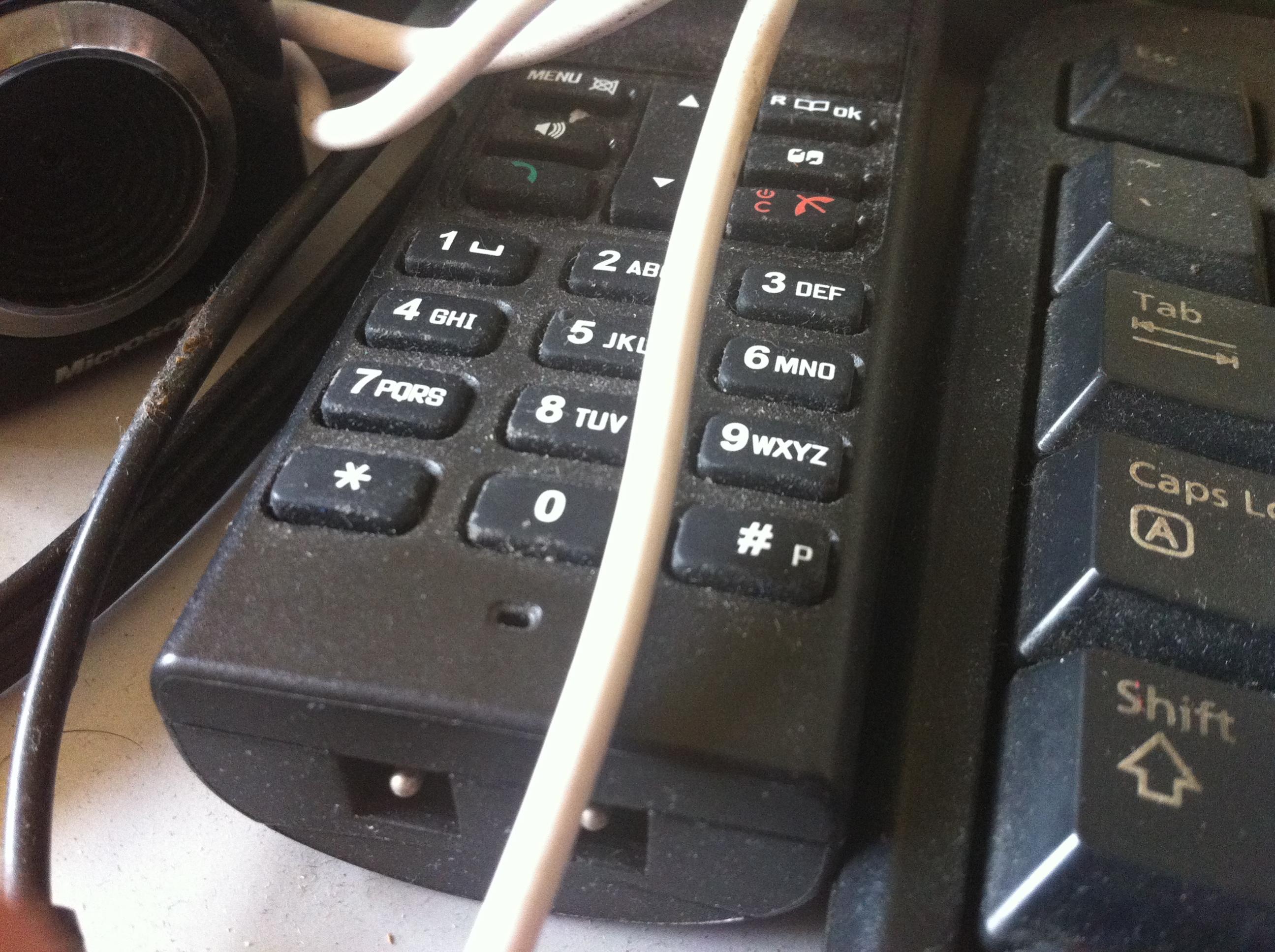

see this:
1 HDR + Original pic. 🙂

see this:
[img ]http://hphotos-snc6.fbcdn.net/172205_196411520387645_100000563947664_694701_5360499_o.jpg[/img]
[img ]http://hphotos-snc6.fbcdn.net/176549_196411627054301_100000563947664_694702_256360_o.jpg[/img]
what's the point of the pictures, other than showing everyone that you need to dust?
