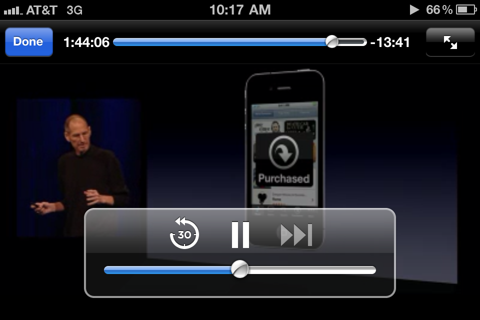

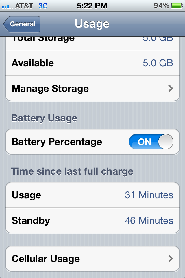

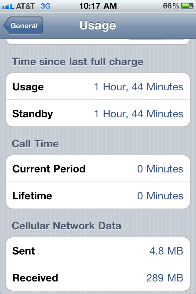

Hello, Apple just replaced my iPhone 4 due to a hardware issue. The replacement phone is refurbished but works like its brand new. My only concern is the battery. I feel that it is draining to quick. This morning i restored it to 4.3.5 and set it up as a new iPhone. I charged it to 100% and started to play apples latest keynote. I attached some screen shots of my percentage, cellular data usage and time spent using the phone and standby. I also included a screen shot of the keynote from where i stopped watching it. Can someone please tell me if my battery is normal. No other settings were changed, no mail is setup. Immediately after the clean restore i opened safari and started the video.

Streaming video off 3g is one of the most battery intensive things you can do. The phone has to use its radio to download the video, it has to use its processor to decompress the video, it has to use its speakers to play the audio, and it has to use its display to show the video. Most other tasks don't use those 4 parts of the phone all at once.

Is this how you are going to typically use it? Cause in my experience, I use my iPhone 4 to text, email, make calls, watch the odd video (usually stored locally), play some games, and a fair bit of idle time - I don't use it much while I'm at work. I mean, as Daniel L said, you are using many of the most draining functions on the iPhone. I believe that iPhone 4 3G BROWSING (which is less intensive because you aren't constantly downloading data while browsing, and the screen is much more static) rated battery life is 7 hours. It looks like you did 3G video watching for 1.75 hours, and you have dropped to 66% or roughly a third. Multiply this 1.75 hours by 3 and you extrapolate to the time it would take to drain the battery completely - 5.25 hours. Given that the rated battery life for browsing on 3G is 7 hours, and what you are doing is a fair bit more intensive, I'd say the battery is probably just fine

No problem. Actually according to Apple's website, browsing battery life is: "Up to 6 hours on 3G".
So you're doing pretty well I'd say 🙂
